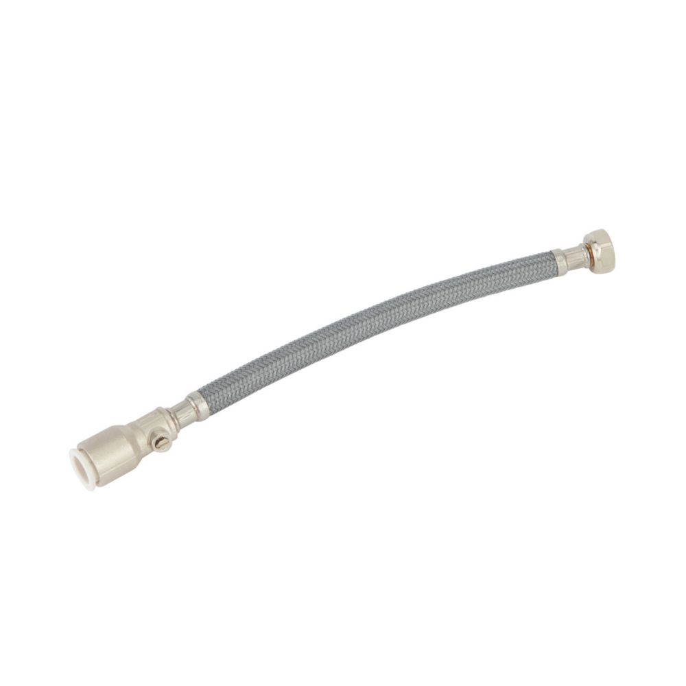

Ahh just spoted this flexi hose is push fit and has an isolator valve..would this be the best solution? IS push fit secure, or am I better off with a compression fitting?
15mm and 22mm are standard pipe sizes and you're almost certainly looking at 15mm at the point of a tap or toilet etc being fed. So that should inform your choice of cutter and service valve etc.
I like both push fit and compression - push fit are more toolless and less fiddly so don't be afraid to buy some decent push fit (JG Speedfit or similar).
Push fit although I don't like them are supposed to be ok
The other end needs to be the same as the tap. Infact some kitchen taps come with the pipes in the box. Might be worth checking the contents description firs edit. They do come with flexi pipes but will need a islotation valve to fit those
The other end needs to be the same as the tap. Infact some kitchen taps come with the pipes in the box. Might be worth checking the contents description first

So thats a few quid saved...might buy the tap first and see exectly ehats included as I might not need compression fittings aswell?

For ease I would have the push fit pipes and not use the ones in the box.

To 12mm these are the ones on the taps
And the push fit flexi pipes will do that
