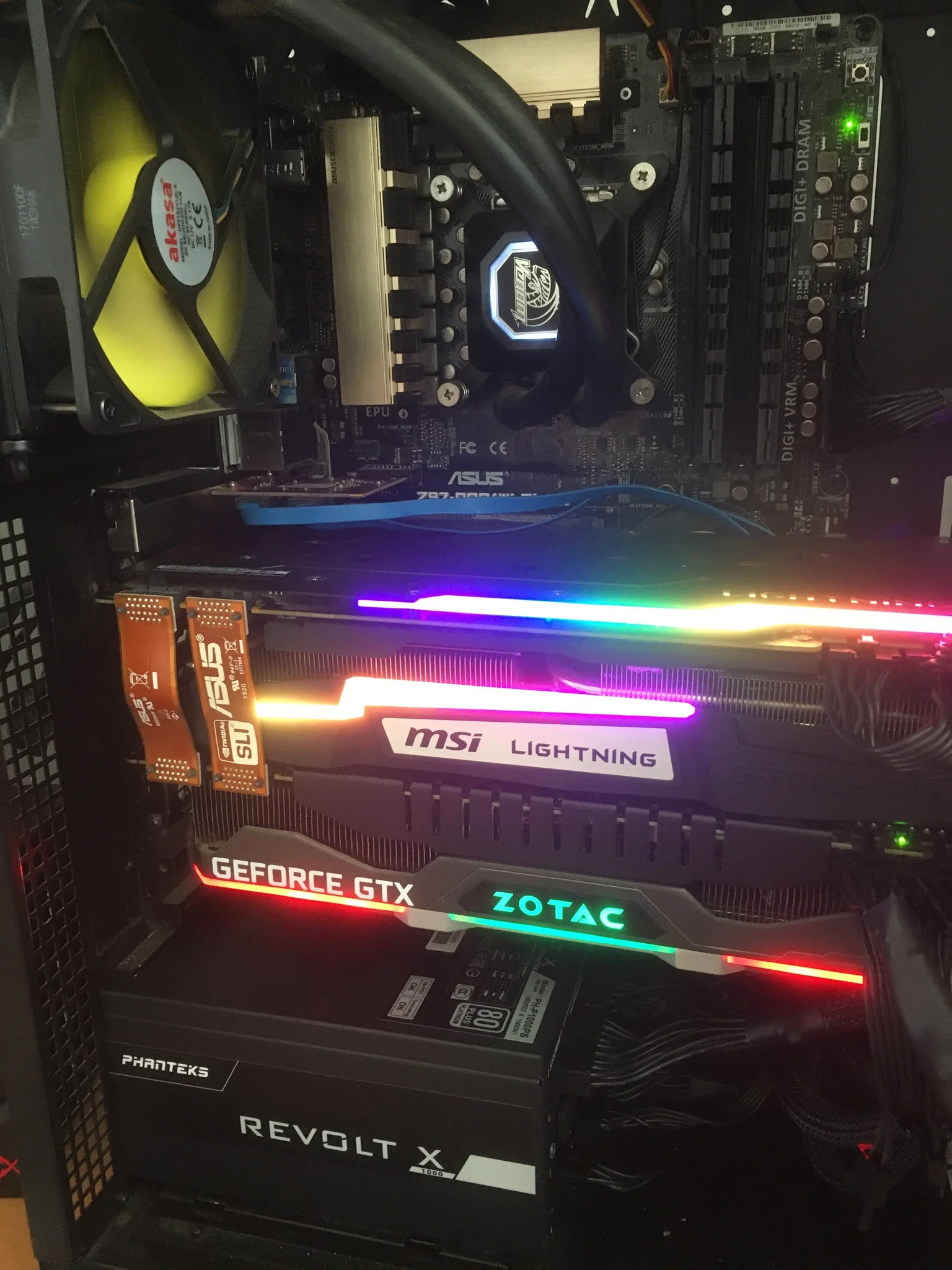

I'm Playing around with my new SLI setup,an MSI Lightning X 1080ti B-Grade purchase which I bought to accompany my Zotac 1080ti Amp Extreme in SLI, I’ve encountered a problem (other than crap airflow! :D)
The HB bridge I borrowed from my mate does not sit properly on the SLI connectors, because both cards are non-reference designs they are slightly too big, the bridge will connect but it’s not sitting flat due to one card being slightly taller than the other and it comes loose as a consequence which causes flickering and an error message in Nvidia control panel.
It’s fine if I wedge something on the bridge to hold it in place but this isn’t ideal...
So I’m currently using two standard SLI ribbon connectors with no issues bar a slight drop in performance that’s not noticeable in gameplay.
I’m minded to just leave it because it otherwise seems to be working none the less, or is such a thing as a flexible HB SLI bridge available? - I'm looking but all HB bridges seem to be a rigid design.
I'd definitely swap the cards as it'll slightly increase clearance between them and airflow that's if they're slightly different in depth as the photo suggests, you can get longer flexible SLI bridges 10cm ones and they're £2.50 on the bay.

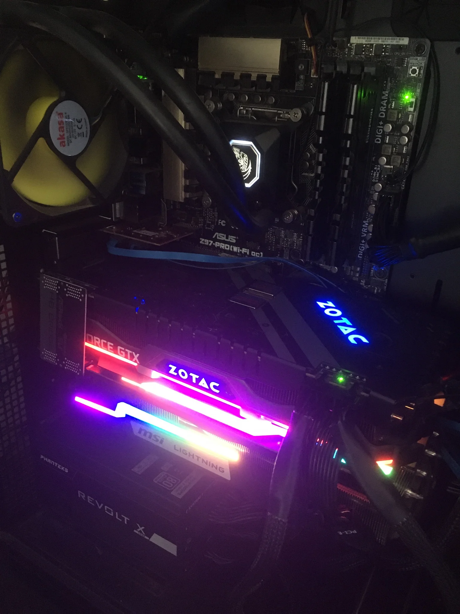

My nephew has a Zotac Amp extreme, I’m going to see if he fancies swapping it for the MSI which should sort my issues with the HB bridge and they should both run at the same faster speed.
I’ve tried having the Zotac as the top card and the temperatures if anything are higher, so two together could be toasty...

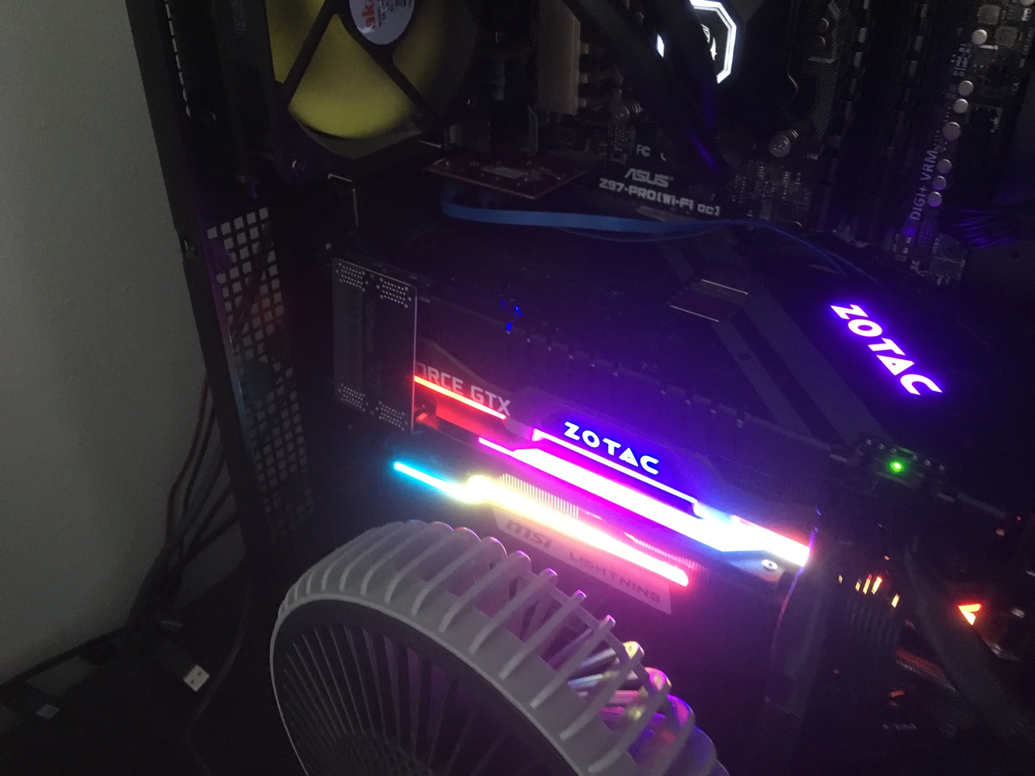

Just got back from visiting my nephew, he was interested in the MSI Lightning, especially given it has a 3 month B-Grade warranty (possibly more if MSI accept the warranty registration...) but, alas the MSI is a fair bit longer than his Zotac Amp Extreme and without removing cooling fans from his case it wouldn't fit.

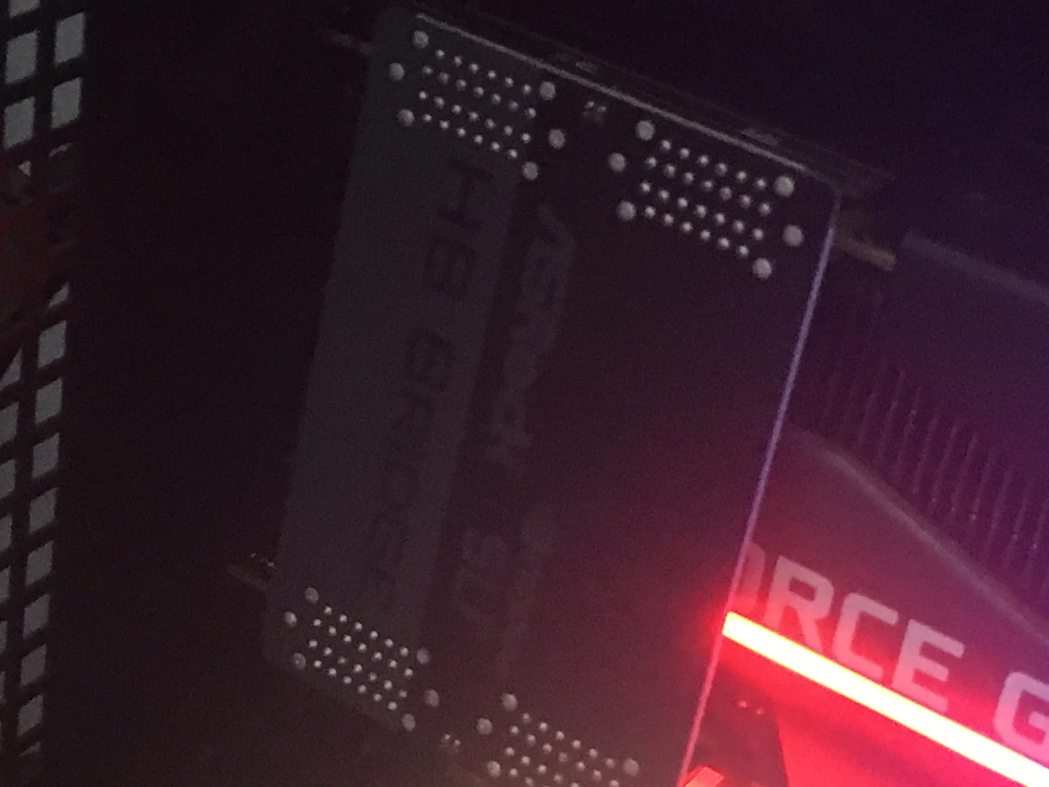

But, he had an AS-Rock HB SLI Bridge that came with his motherboard, I've just tried it with the MSI & Zotac cards and it wouldn't fit with the Zotac as the bottom card but does (just!) if the Zotac is back on top....
With my newly aquired B&Q desktop fan blowing onto the cards, temperatures are not too bad (hottest card now ballpark 75c) and full performance is restored, and a micro stutter @ 4K is now gone.
Might stick the MSI up on the MM to see if anybody fancies swapping a blower card for it, my previous GTX 580 SLI and 1070 SLI setups were both reference and triple fan type cards, which seems to give the best temperatures if not the ultimate in performance due to SLI defaulting to the slowest cards speeds...
Still, for the boost its given in Project Cars 2 & GTA V @4K its well worth it. :)
