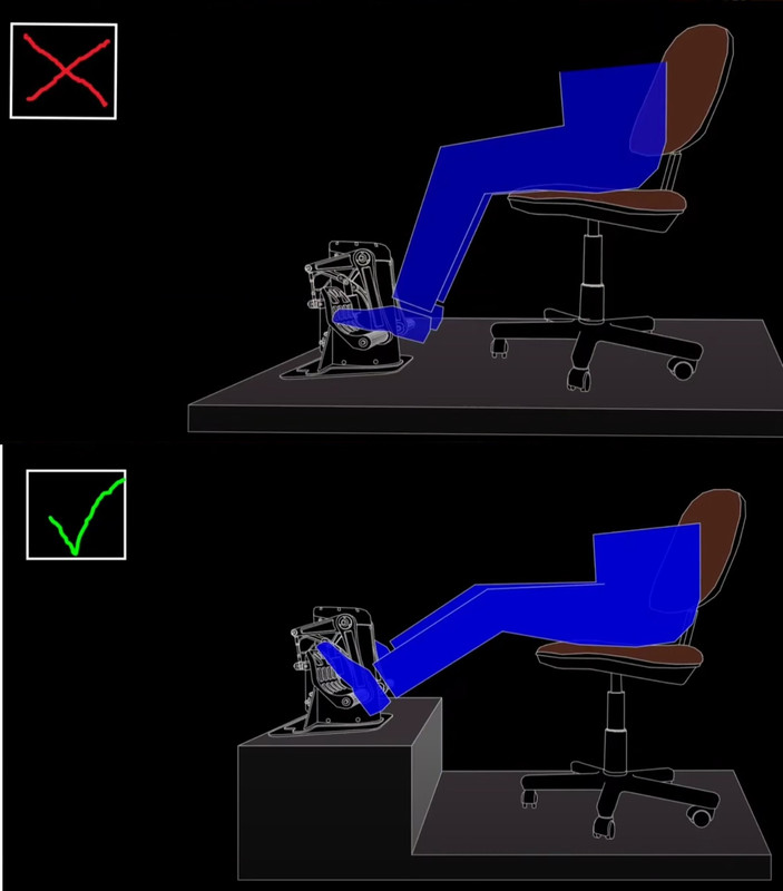

Basically, there are three approaches to rudders - the slider type (e.g., Crosswinds, Virpil, Slaw, CH, Logitech G, etc), the push down type (VKB T-rudder, etc), and the pendulum type (Thrustmaster TPR, etc). The pendulars are the most precise and the most comfortable but ideally require a more horizontal seating position - see the pic below. The sliders are more forgiving in that respect.
Guess TM TPR's are likely going to be the most appropriate for my setup then. I'm reconfiguring my Alu profile race sim to fit this setup. Pedal plate is adjustable and already in a raised position.

Ref the TPRs and profile, mine are bolted directly onto a couple of profile crossbars. The TPRs need to be mounted on a horizontal base, which makes them dead easy to attach.
