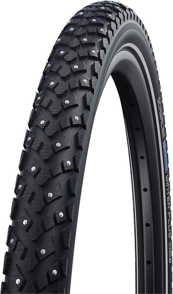

I'm just off into the garage to put a pair of these on.
I do it every year the cold weather comes and I know it's going to be black ice in the morning then I'll take them off when I'm pretty sure we'll have no more black ice.
I used to fit 38mm 45Nrth Gravdals with 240 spikes to my commuter in winter once we had overnight temps dropping to near 2C, brilliant for grip at the cost of being draggy, although inflating them more helps on days it looks safe.
When I first put them on a few years ago one day it had snowed and as I came into my street two lads were playing skidding on the ice.
I knew who they were so I asked if they would try them out for me, no way at my age (I was in my 60s then) I was going to do teenage tricks.
This lad tried his hardest to skid round the street so I was well satisfied, obviously I'm still cautious because over the years I've ended up in A&E 5 times because of black ice.
