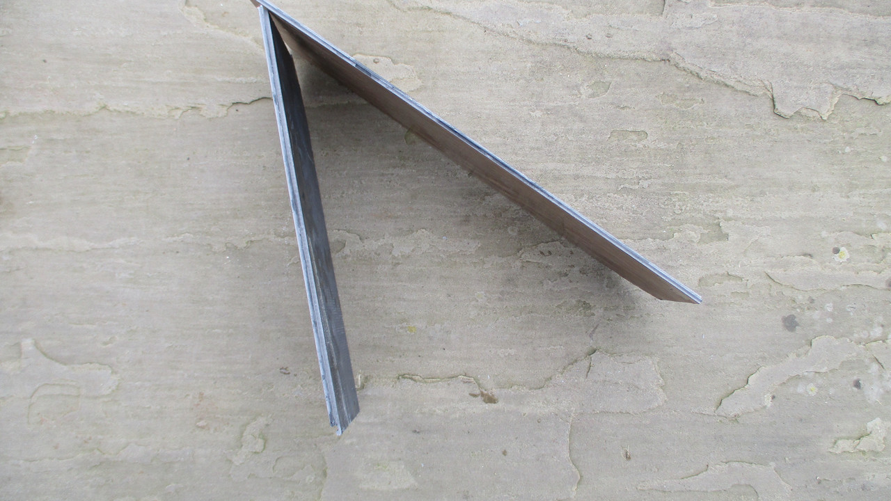

These off-cuts have been outside all Winter, I was skeptical what would happen if we had a flood.
Turns out we had nothing nothing to worry about with LVT, we used Novacore easy to take back none used boxes to Wickes.
The Floor needs to be 100% Level for click-together. Also The recomended glue down stuff is replaceable as well.
