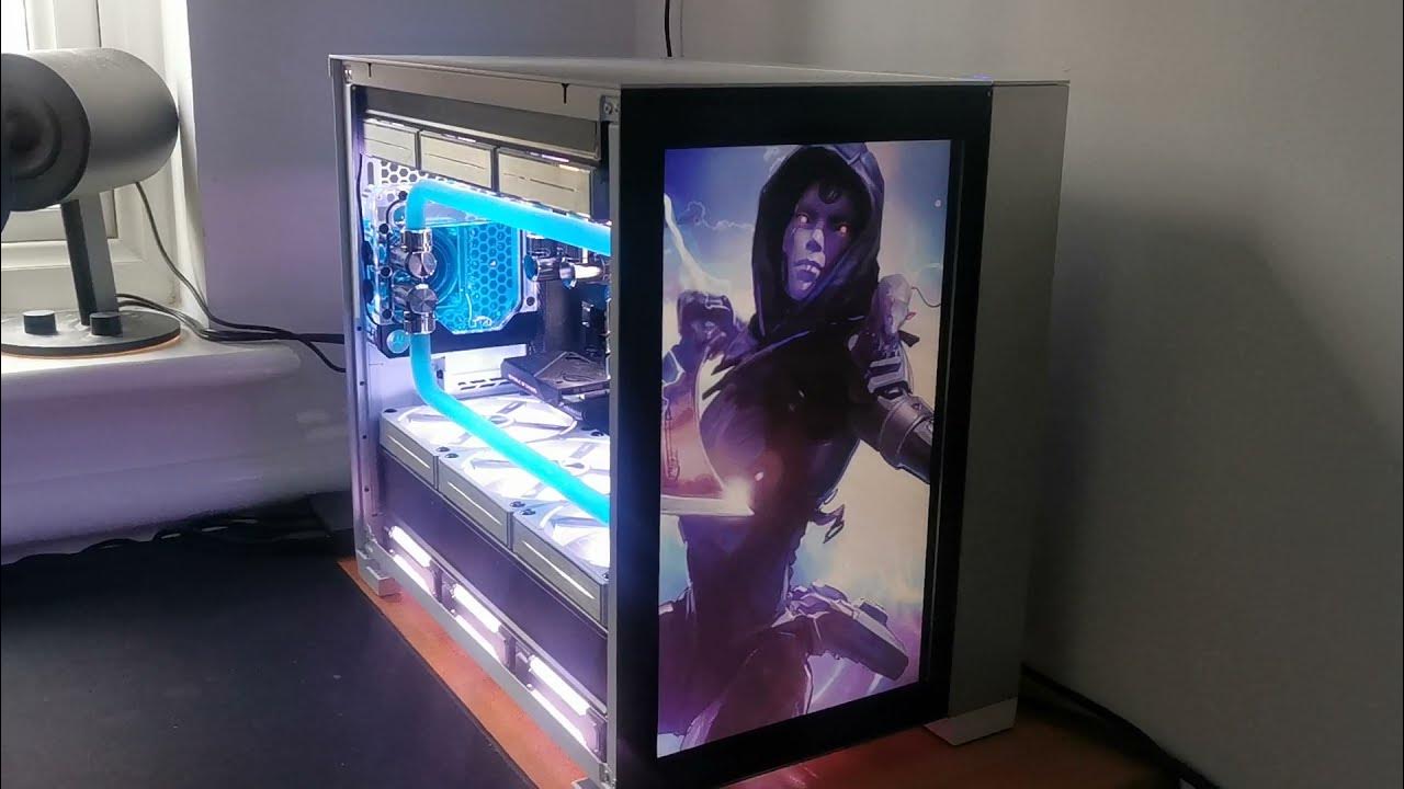

im building 2pcs both with loops. i cannot work out how the hell to get rid of the foaming.
both seem to have the same issue, the inlet to the res has a tiny air gap to the water level (no straw to put it lower down) this creates bubbles which then find themselves getting to the outlet port, this shoves airt round the loop and makes it foam like mad.
1 loop has been running on an off for a week and its still exactly the same. the other is a new loop for a new pc and an hour in its just doign the same thing.
how the hell do you prevent foaming?
the existing 1 is using a front distro plate and the new 1 is a flt 80 ekwb box res
