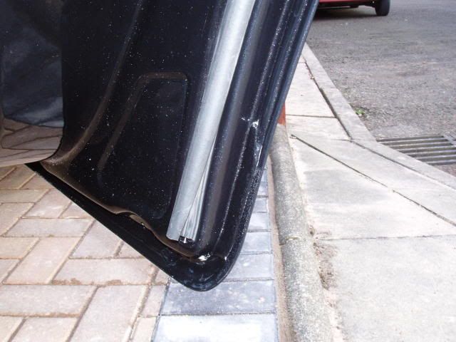

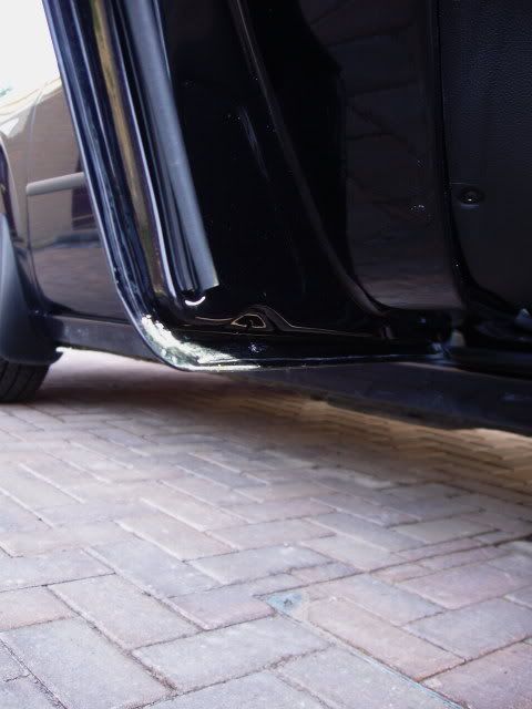

Finding door / tailgate seam corrosion due to sealant problems with my 53 plate Mondeo I managed to get them to fix it under warranty (after a couple of months phoning garage and chasing the warranty claim up!).
Dropped the car off at the Ford bodyshop Monday, got the car back yesterday evening, and today I managed to get a look at what they have done.
Rear passanger door before:
After:
(Not a good photo, but lots of fresh sealant and paint)

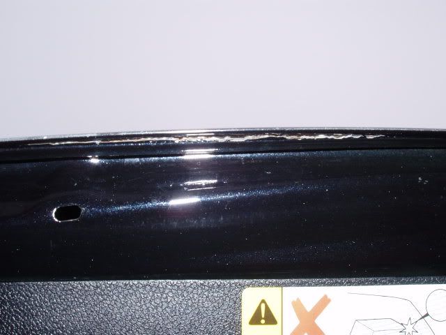

Tailgate Before:
and
After:
and
again lots of new sealant + paint. Ford have taken fresh sealant all the way around the tailgate.
Drivers side rear door was starting to show paint bubbling, and looks like Ford have stripped it back and redone the sealant + paint after treating the rust.
Fixed:
Not too bad a job, at least it didn't cost me a penny! :)
I guess the real proof in the pudding will be if any of this new sealant / paint starts peeling off in a few months time :rolleyes: However once the paint has fully set (a few weeks?) then I'll get plenty of wax on the door and tailgate edges.
OllyM, it's a known problem with a bad batch of doors / tailgates made in 2003 / 2004. Seems they didn't bake the sealant on properly before painting.
However free repair from Ford!
It's not a bad batch, it's a combination of the design of the clenched flange protection and bad sealant that soaks up moisture and deposits it into the metal where it's not galvanised. It affects cars from the start of production to late 2004 when they changed the design of the doors. I had a bit on the back doors of my 2002 Mondeo when I got rid of it, the 2005 one I swapped it for had the new doors and didn't have a problem. I've seen them much worse than this one - I looked at a 2.5yr old one that had lived by the sea and had big holes in the bottom of the passenger door. Definitely something to check for if you're buying one.
