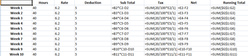

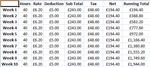

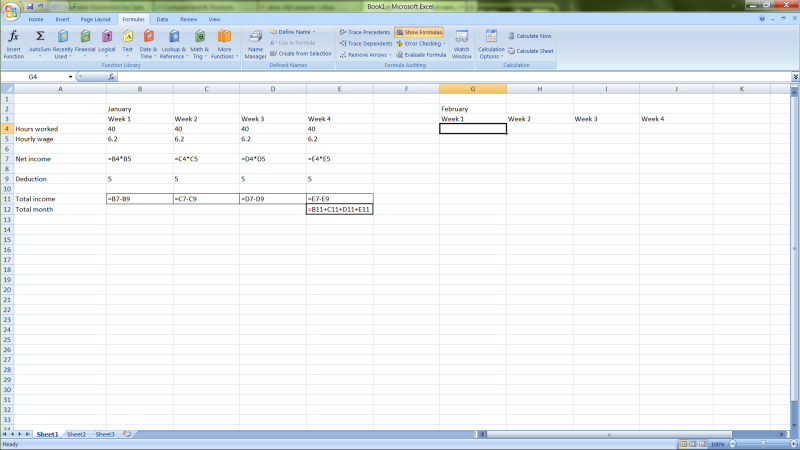

A simple spreadsheet, Ill do a quick mockup of what youve said and post it on here to give you an idea.
Just from the information you gave (40 hours pw, 6.2 hourly wage, 5 pw deduction)
Formula view so you see how I got it.
