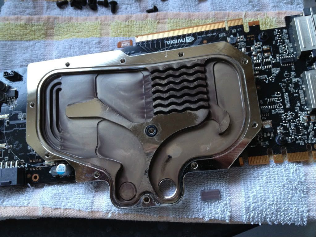

Anyway, I decided to take my blocks apart as there was some slight growth on the inside of my ResTop (binned).

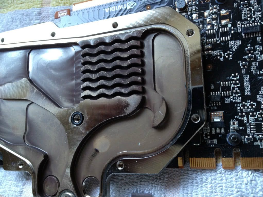

This is what I found once inside the GPU block (EK 580, feb '11)
CPU was much the same (HK LT v3), but I'm having a job cleaning whatever is in there out of the micro channels. It is currently submerged in a cereal bowl with white vinegar and tommy sauce. So far no amount of rubbing with a toothbrush seems to dislodge whatever it is that is in there. I'm guessing that this is Algae?
Would someone mind confirming please?
Looks like the corrosion issues. Need to RMA it i'm afraid :(
Get a second opinion before you do. Might be worth contacting EK via their CS section :)
Also, you're sig is a line too big, maybe remove the space?
agree with cleeecooo definately doesnt look like algae.......looks like its been getting really hot though where it sits on the gpu......or do they all look like this over time?
if it wasnt a water block i would say there seems to be a lot of soot in there lol......

I'm positive it isn't the flaking/corrosion issue, I did wonder whether the areas just below the GPU and the one just to the left (top pic) looked like that from the photo but it's just where I have rubbed it with my finger
Funny that as when I rub it off with my finger it does look like a sooty deposit, thing is that any monitoring program I have used has never reported the card go over 42°c

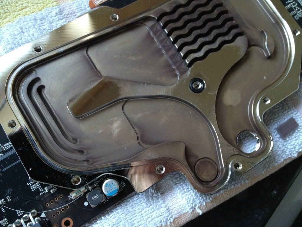

This now makes me think twice about my reply to cleeecooo, the center screw from the block looks a little rusted from the point where it screws into the block to the bottom, it also needed a touch extra to get it undone.
From the pic you can clearly see the area of the screw affected, and that it's the only one

The dark area around the center screw looks like it explains the rusted screw...
The thing is though that the thread of that center screw looks fine...wouldn't it be fouled if corrosion of some kind was the problem?
So I can only assume the o ring around that screw has failed to do its job?
Also, I'm fairly sure that if I cleaned the block that all the nickel exposed to water would be fine, it doesn't look to have suffered any corrosion
The thing is though that the thread of that center screw hole looks fine...wouldn't it be fouled if corrosion of some kind was the problem?

You shouldn't leave nickel plated blocks in 100% vinegar for a long time since it starts eating away at the plating.
RMA has been issued (not OcUK) and I'm going on the theory that the whole system has been fouled due to the center o ring failing and thus the screw coming in to contact with the water. This is the first time the block has been apart, so it wasn't user error in not fitting the Acetal back properly.
The CPU block looks borked, the plate spent the night in a white vinegar/tommy sauce mix (before that it had been in some mouth wash) but a good scrubbing this morning hasn't made a blind bit of difference :( The build up is in the lowest part (center) of the micro channel; would it be right to assume that the heat from the contact with the CPU has baked this stuff and that I'm not likely to shift it?
If so then I suppose that means a new CPU block... :mad::( or would I be able to source a new plate?
