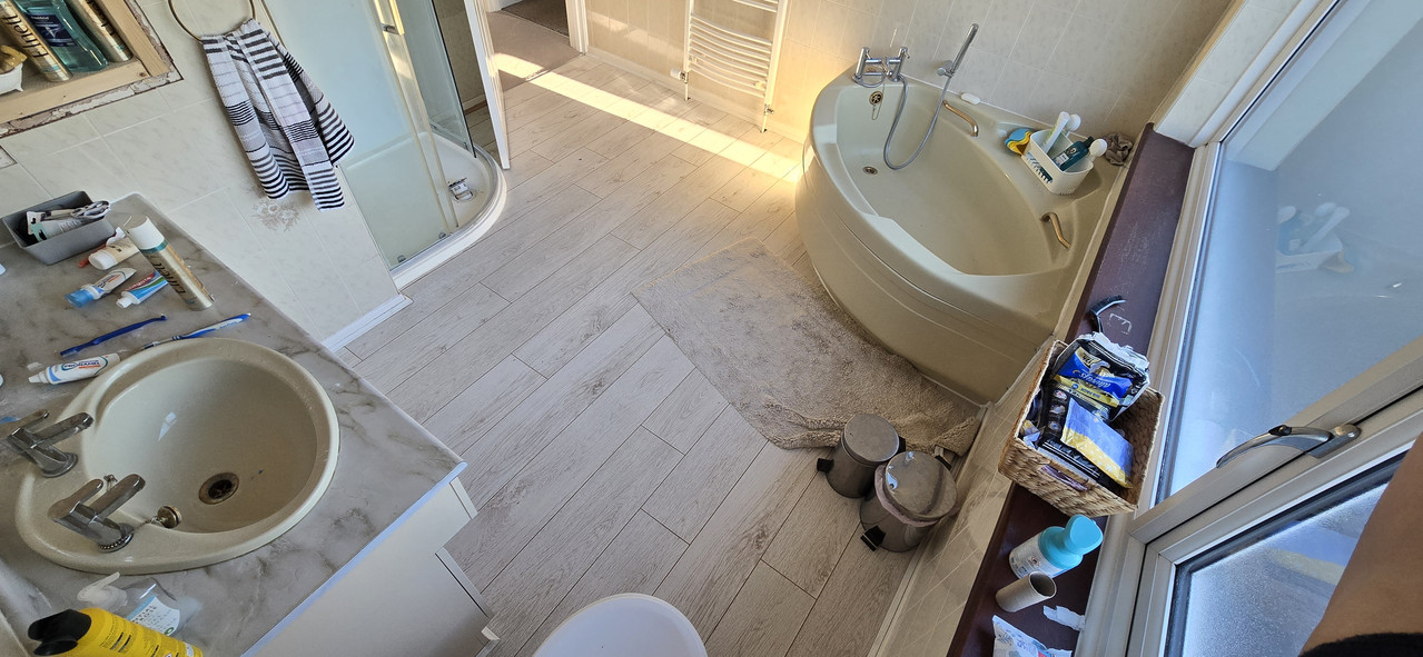

I'm about to start on my main bathroom project (est. 1990?) and just trying to decide between built-in bath vs. freestanding.
Any opinions from people that have freestanding baths are gratefully received - they seem to be very much in fashion and I do like the idea of a really deep bath, but are they a pain in the bum to clean behind, is the plumbing / installation harder, any other downsides?
I've obviously used them in hotels etc. but never had one in my own house living with one every day.
The room layout, which will be kept largely the same as it works and the plumbing is in the right place, is as follows:
It's quite a large bathroom so I have options but the broad plan is wall-hung WC and vanity and wet-area / walk-in shower with lots of stud work for niches, shelves, and a recessed cabinet.
Many thanks.
P.S. sorry about the female paraphernalia - please ignore, I just noticed it and cbf to edit / retake!
Who cares? I'm more concerned about your safety standing on that toilet to take the picture :D
