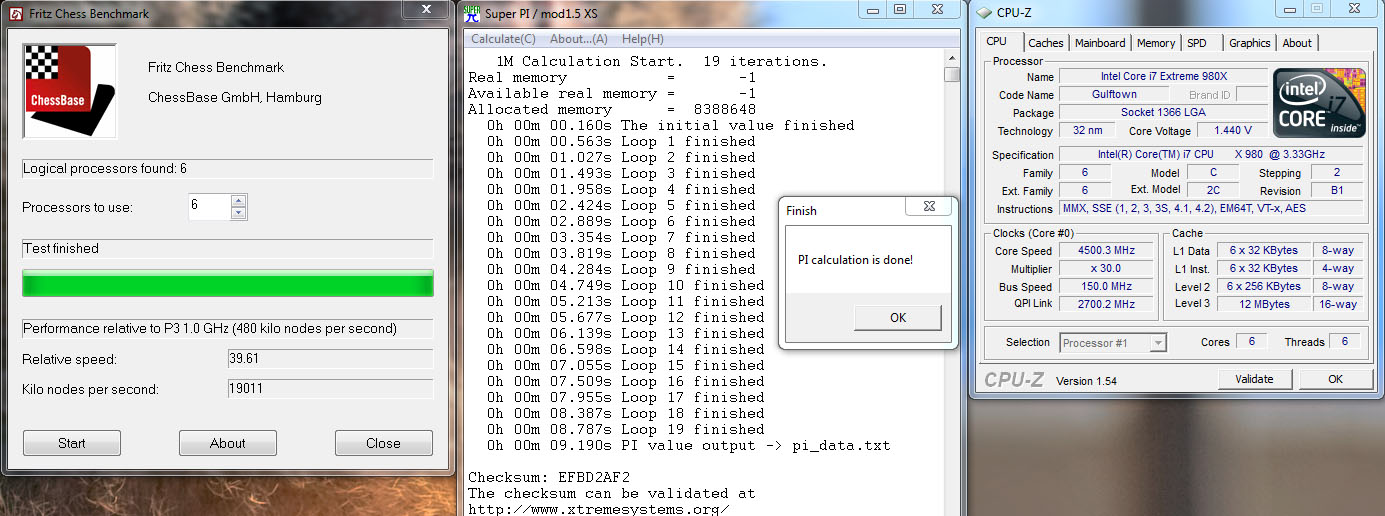

@ simulatorman - whats up with your results??
You score higher than any quadcore thats clocked higher, even though Fritz only uses up to 8 threads so you have no advantage over a intel quad with your 980. As Fritz cant use the 12 threads on your CPU.
My 980 is also clocked higher than yours and i get a better time on super PI, but your Frits is higher....
You can turn off HT so Fritz uses 100% CPU usage but then fritz will only allow upto 6 threads, not 8 like in your pic.... so how'd you manage it?? :confused:
