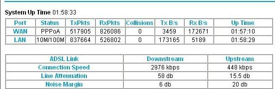

Dave2150 said:
BT said 1.5mbit for my line on max, but im getting 3.1mbit - definately worth it for me.
Stats on BTW 1mbit:
Stats on BTW MAX
Note that im now syncing @ 3.1mbit, so I should get 3mbit data throughput when the BRAS updates.
I like how your SNR changed so much for the better...
