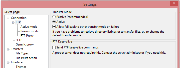

Try forcing the connection on active mode.
It's in settings > connection somewhere.
edit: had some time to check it.
It's in Edit > Settings > Connection > FTP then choose the 'Active' radio button.
