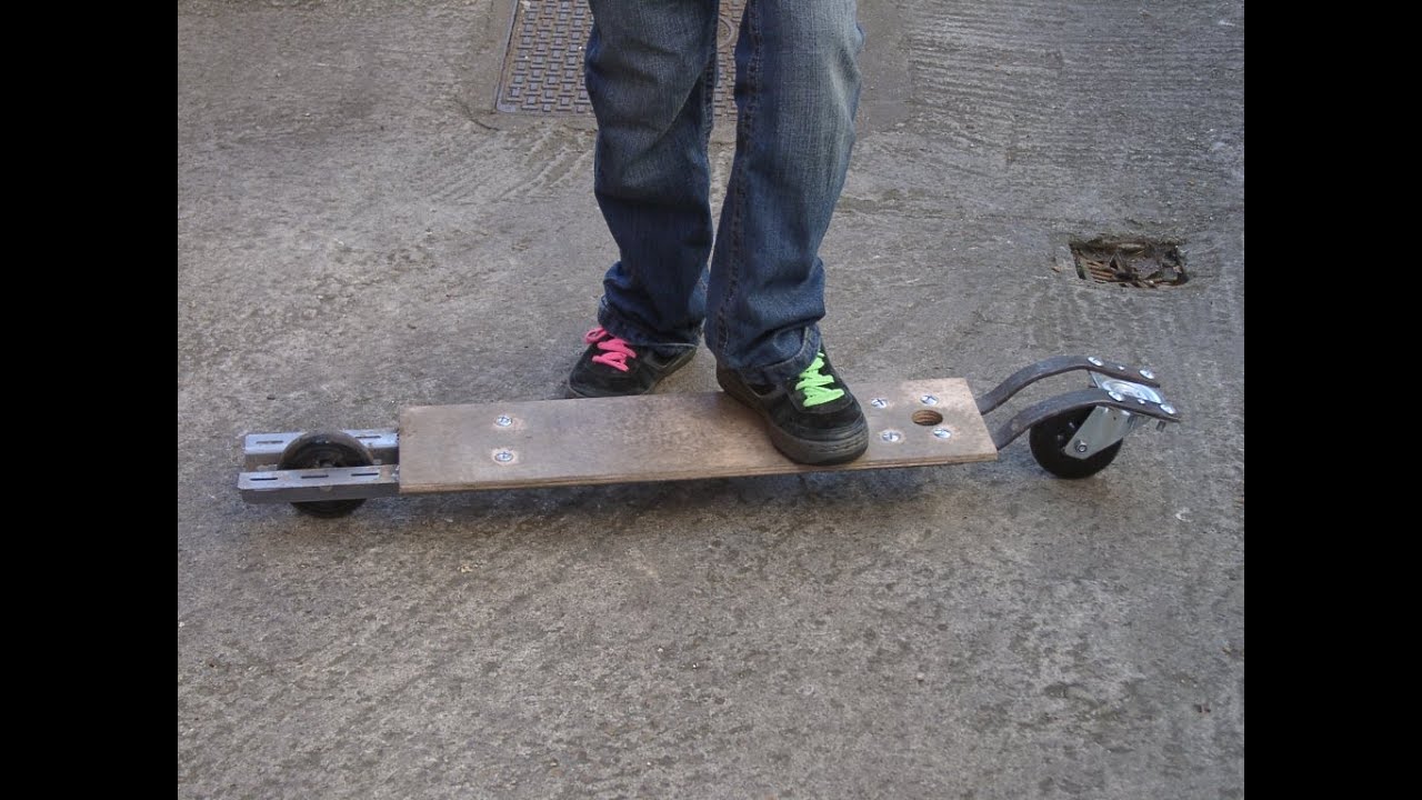

Well....... if you had that, feet forward layout, like a car say, so the handlebars are quite a long way back from the front wheel, and you just put tellies on it, the rake angle would be huge, and it wouldn't handle nicely. The advantage of this layout is that the seating position is just like a car (without a seat rest) . The seat is the same height as my family car. At that height, you are 2/3 the height of a 'normal' bike, and the same width, so your frontal area is 2/3 of a normal bike, so it has 2/3 the drag, so it goes faster. That said, the wrong way round steering self-steers better than a normal bike and it feels really secure, especially on very tight turns. I even made a two wheel skateboard with the steering axis the 'wrong' way round. https://youtu.be/5MQ7qDzfENo You can see that it steers the same way you lean - even without handlebars. If you used a 'right way round' steering axis angle, it wouldn't work.
