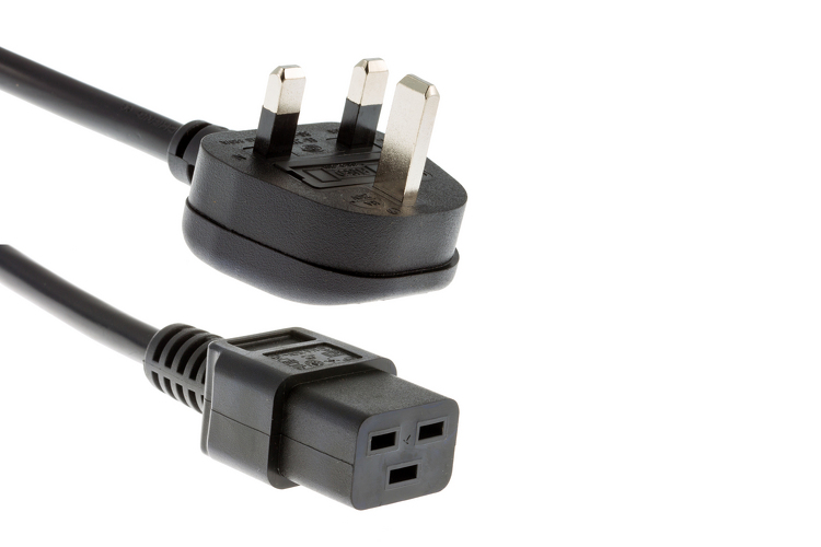

The Corsair 1600watt uses a higher rated C19 to BS1363 UK Power Cord.
