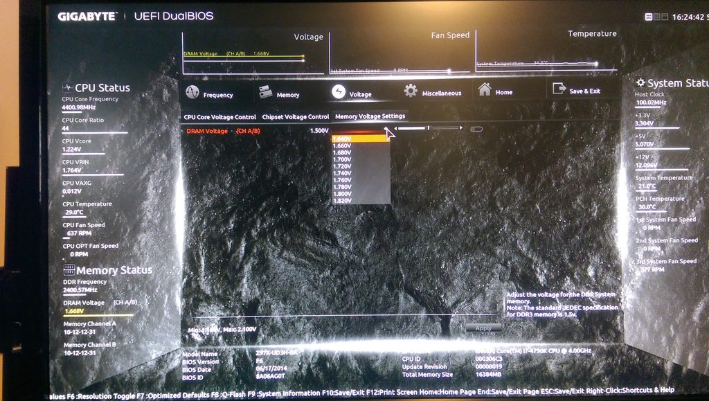

OK here below are all my settings and photos including info of my spec:
If you need more info please let me know.
Go memory voltage 1.65V. IMC voltages SA +0.25, IOA + 0.2, IOD + 0.1. Timings TRFC 400 TWL 9 to start with. Test!!!
Which ones i should change and on dram voltage i can do or 1.64 or 1.66 there is no 1.65. i did set 1.66 and running test. What stats i should change and which way?
