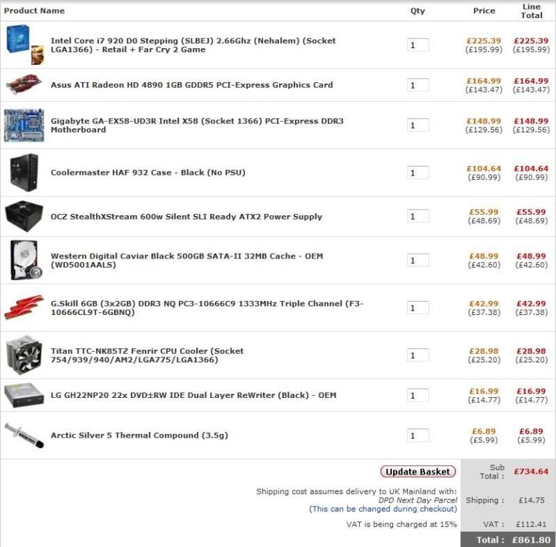

Well i was originally getting a setup similar to this just with a new screen and other stuff but the person that was gona buy my old pc has now dropped out meaning i have to lose the monitor and some other things but iv come up with this spec...
Just wanted to get your opinions on it.
If yuou can do without the bundled games I'd suggest getting this asus 4890 it's a volt modded version that has higher clocks
When i first saw this product i thought it was a typo lol. Then people left reviews, but i still wasn't sure because it is 100mhz core higher than standard ones. That clears things up. Thanks haha.
Not a big difference, but definitely an improvement and when you're talking about it being the same price, do you need to question? :p
If the 950mhz was more expensive then fair enough, but being the same price why would you go for the XFX one?
I added another spec to my OP, lol i change my mind too much >.< i think spec 2 is better as im going to mainly be gaming but unsure just like to get your thoughts. Also i will only have a 17inch monitor for a month or 2 until i sell my old computer, but i have found a 24inch monitor i like:p so i will be playing games at 1980x1080.
+1 for spec 1
The 4890 should be more than enough for gaming and the i7 is much better tech - so it will futureproof you better than the DDR2 Phenom 2 setup (even with a 4870x2). Aslo, in a few months the prices of 4890s will have come down even further so you could add in a second if you feel you need the extra performance.
Just noticed that the HD4890 takes 2x 6pin pci-e power connectors yet the power supply i listed only has 1 x 6pin and 1 x 8pin:S Is there another PSU around that price that will run the setup good? Or is the 8pin actually a 6pin with a 2pin?
I thought i needed it to clean of the thermal paste already applied to the Titan Fenrir unless it doesnt come with any pre applied? Also im going for option 1 even tho it may not have a better GPU i can always add another later and the i7 is much better then the phenom 940 also i think the i7 setup will have a longer time before i need to upgrade.
