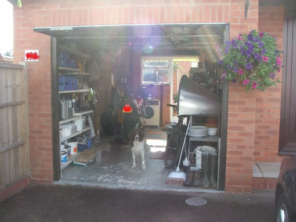

I’m wishing to convert half of my garage this winter into a small office/computer room.
I would like to do most of this work myself. I am no builder, but I am in no rush to finish it so would like to learn as I go. I am sure this is feasible?

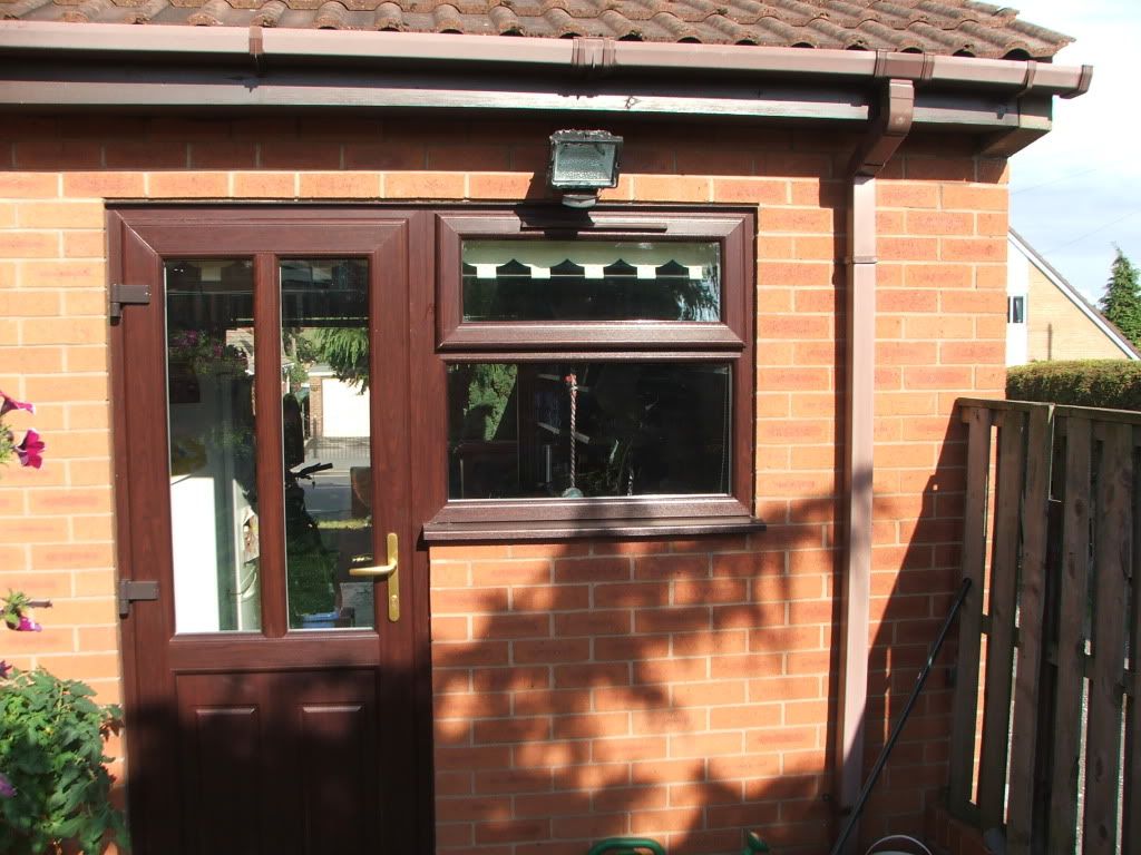

Attached integral garage. Up and over door at the front and recently installed new UPVC double glazed window and door at the back which leads onto the garden. Also a door from within the garage which leads into the kitchen.

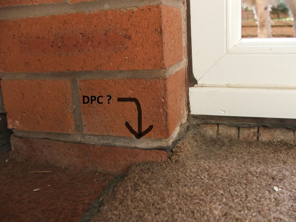

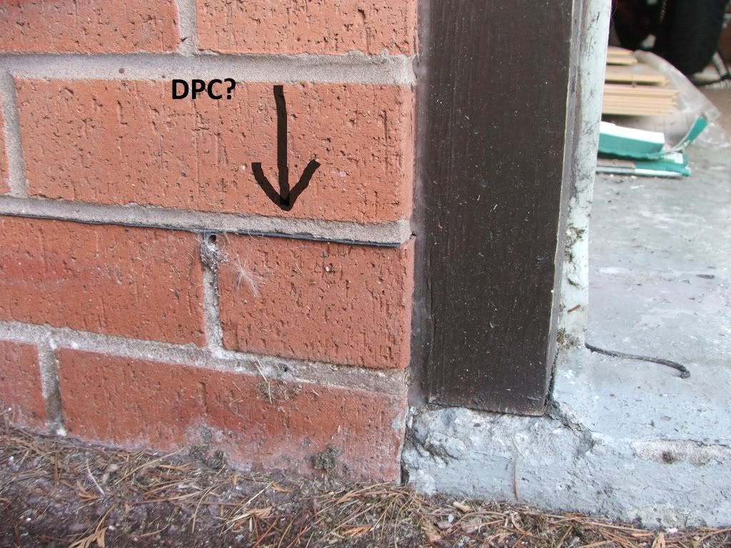

The floor in the garage is concrete. I do not know if the floor has a DPC but all walls at ground level have what looks like a black DPC sticking out.

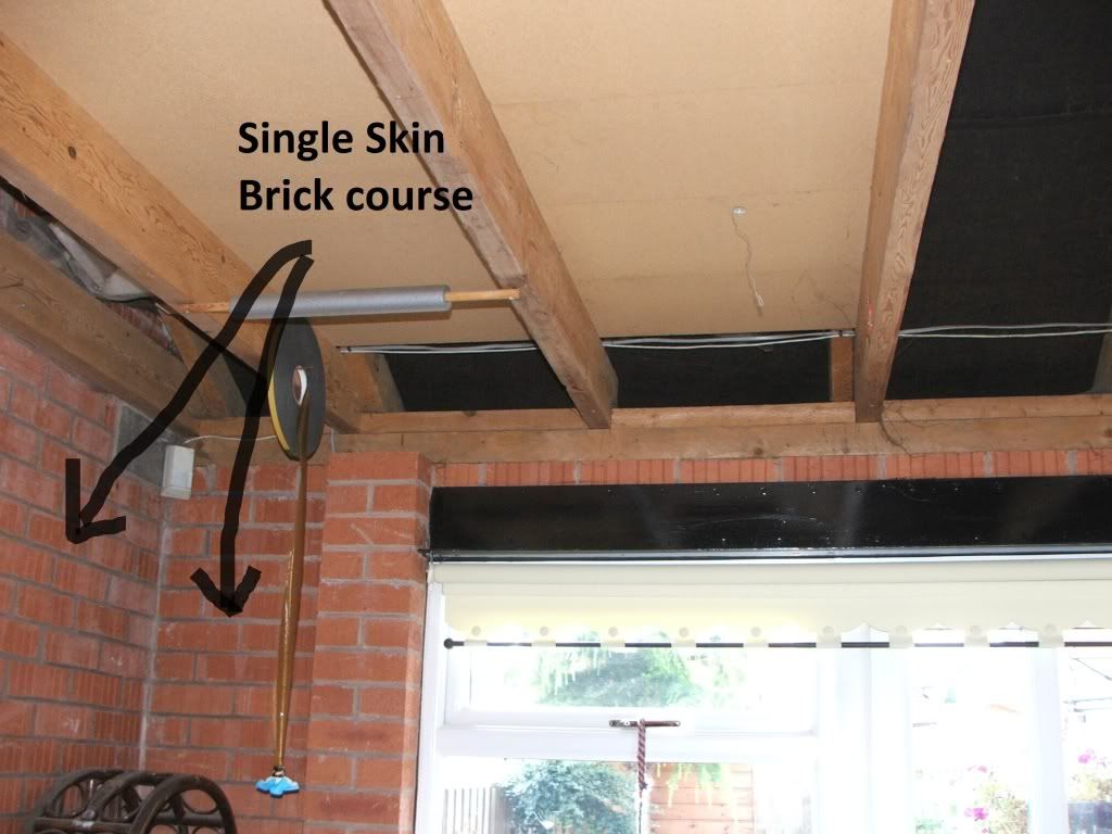

The Back Wall (with window and door) and side wall (far side of house) are single skin brick course.
You will see that on the close up photo.

I want to convert the back half, thus leaving me the up and over garage door and that area so as to be able to store normal garage items and my motorbike.

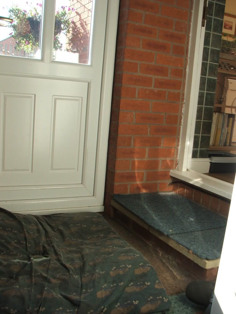

Also, as you can see, the step into the kitchen, not sure what to do with that regarding the floor

Meet my guard dog :)

DPC your best bet would be to paint the floor and walls up to the dpc with a bitumen based product or visqueen under any insulation.

yes these are things i am not sure of, especially the door threshold when i add a floor.

You should take advice but it's not a 'party' wall so you don't need to worry about fire so much, I see your joists are running front to back, mine are side to side which is easier so I just picked one and built down, you need to build a frame in and around then cut in plasterboard, then you can stuff full of insulation and mastic top and bottom.
If you build it out of 100mm concrete blocks you will need to add insulation on one side, if you build it out of studwork say 89mm you can insulate within the stud, saving space, it'll all count.
