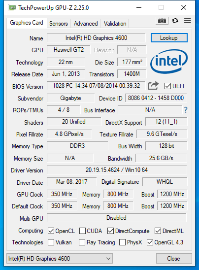

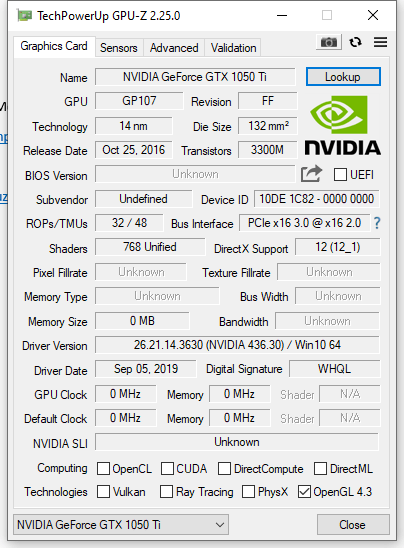

I have attached the GPU-Z links for both the built in Graphics and also the Nvidia Geforce 1050Ti
I notice in my Bios when i remove the 1050ti that i have a couple of options under "Peripherals"
Initial Display Output : IGFX or PCIe 1 Slot
XHCI Mode : Smart Auto / Auto / Enabled / Disabled /Manual
Intel Processor Graphics : Disabled or Enabled
Intel HD 4600 (Motherboard Graphics)

Nvidia Gforce GTX 1050 Ti
http://gpuz.techpowerup.com/19/09/28/k3a.png
Could it be anything to do with UEFI as i notice that the Bios version is blank and the UEFI is unticked on the GPUZ screenshot for the Geforce 1050ti ?
