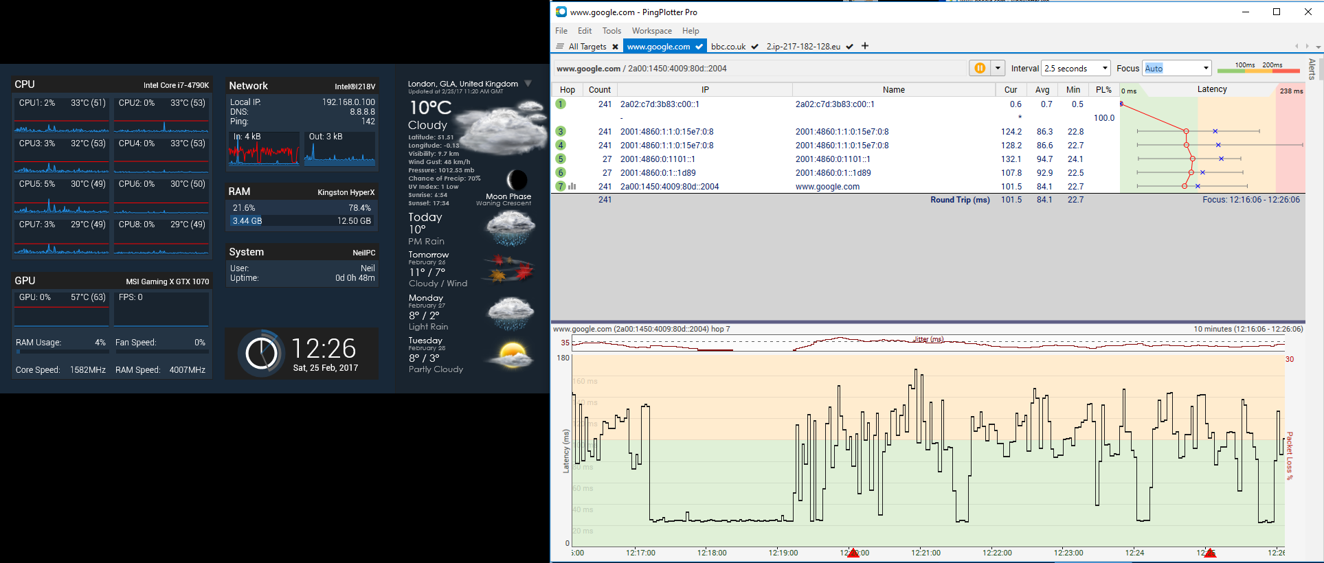

Here are some screen shots of my PC, connected straight into the router, with nothing else wired into it, even Wifi is turned off...
You can see here I was in one of these "periods" where my latency seemed bad.
Ten minutes later all is OK and it was back to a nice low figure again, and as I type this, an hour later, I've even plugged everything back in and I and my son (on an XBox) can all play with rock solid still with low latency again! Those two graphs are now showing a nice 25-45ms response... The odd spike, but generally straight back to something nice again the next poll.

Here's another example of how bad it can get at times...
And sometimes I even see some "current values" returned as "*" during these periods. eg: I can see the value for "be437.pr3.bllon.isp.sky.com" at bad times with a current value of "*"?
Now surely if high pings or "*" to that address show it's something further down the line, but even my speed to my first port of call in sky is slow/laggy?
Note: And this performance is the same to my random game server IP and google.com.
