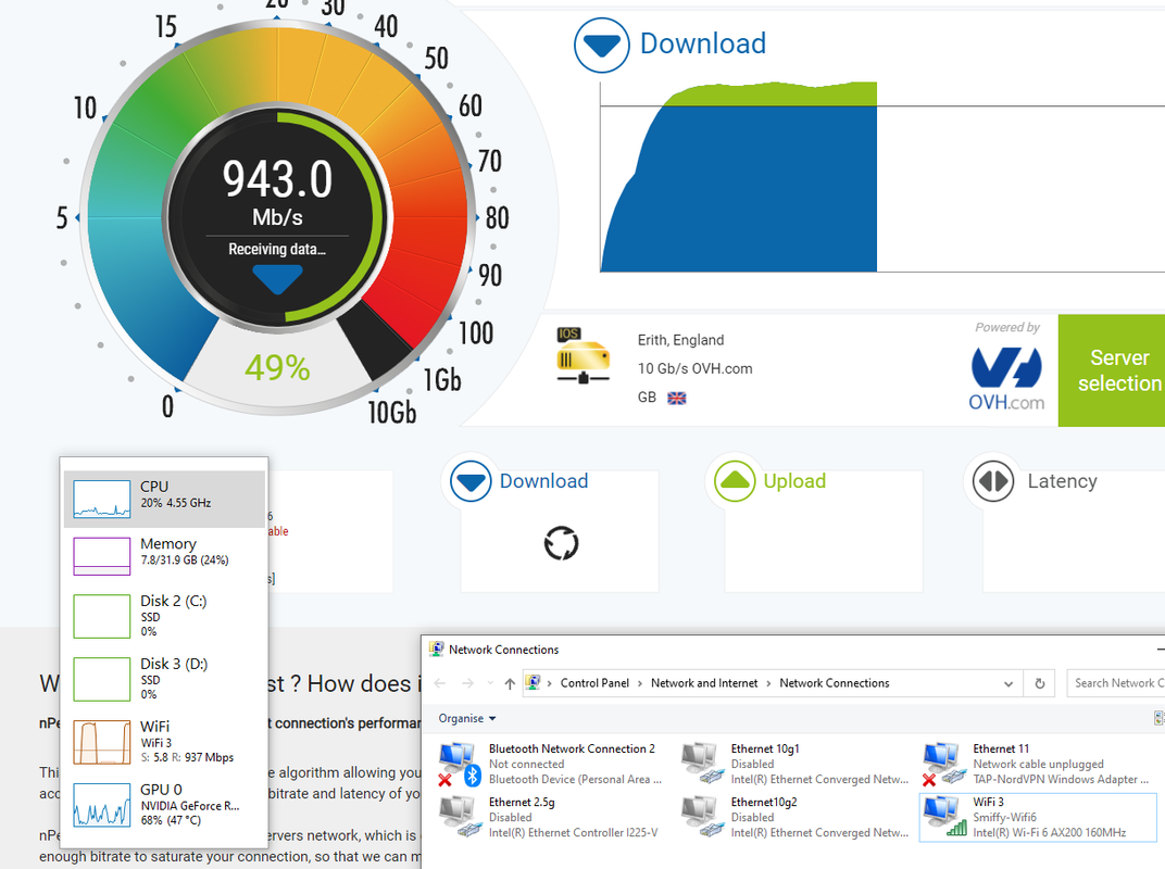

I use some janky AX3, wouldn't necessarily recommend as they aren't the best supported, most secure, have poor range and features devices but < £40 a pop, if you can over look that, does 1Gb with ease on wifi 6 or 5 if you have 160Mhz wifi 5 devices as shown below. As mentioned I put one in each room I wanted performance and wired the backhaul.
