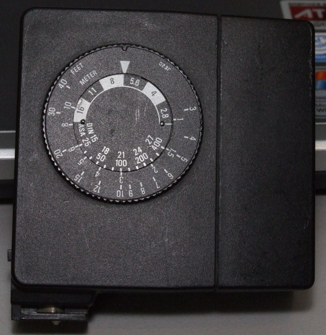

As above - been given a flash - A Sunpak GX20
It's got this on the side...
How does that work?
Simon/~Flibster
The aperture of the lens you are using along with the distance.
Some lens have a distance meter, put that number in.
From looking at it, it looks as though you turn the dial so the white arrow points to the ISO (ASA) you are using (eg 100) and then it tells you what aperture to use at the sync speed at a given distance to get the right exposure.
you turn the inner dial so the distance to subject lines up with the ISO you're shooting at, then read off the correct aperture by the white arrow.
When you're using manual flash the aperture controls the amount of flash seen by the sensor and the shutter speed controls the level of ambient light.
tis good to use manual flash sometimes, teaches you stuff ;)
