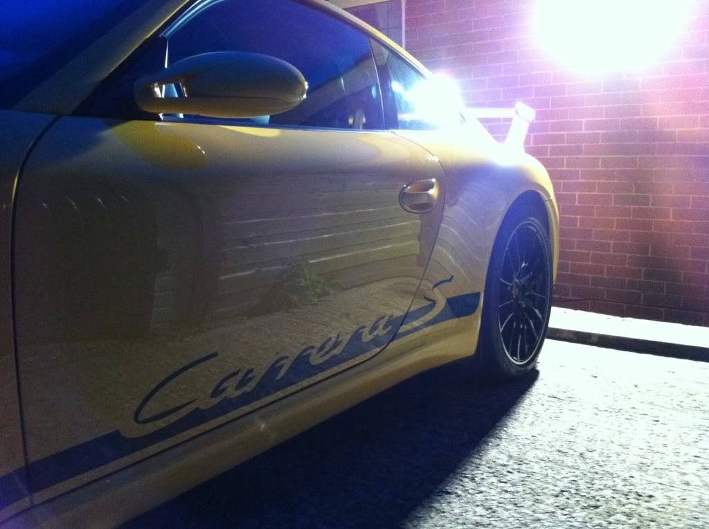

Went to Japfest yesterday in the Jaaag which continues to excel at it's role of being a comfort barge. Anyway quite a few nice cars but more importantly checked out DoDo stand, got their recommendation on what wax to use for a yellow car. I left with:-
- dodo glossy shampoo
- dodo paint cleaner wax
- dodo clay bar
- dodo clay bar lube
- dodo banana armour wax
- assortment of applicators and ultra soft micro fibres.
I then went over to Meguiars stand and got:-
- NZXT shampoo
- lambs wool MIT
- ultimate compound (polish, restorer and swirl remover)
Plan was an early rise Sunday to do all this to the car, but instead I went on a drive to Wales (triangle) with 5 GT3's and Naithwraith, this was epic, but meant I did not get home until 3pm. Still I decided I had enough time to do the car, so I did the following:-
- two buckets, one with nzxt shampoo the other with dodo
- wash car with dodo and wheels with next, then rinse.
- car still wet I clayed the car with dodo clay and lube
- rinse and dry.
- then used Meguiars ultimate compound, damn it's hard to get off, but it did seem to remove some scratches and reduce swirls. :)
- then waxed with dodo paint cleaner wax.
- then applied banana armour wax.
The results:-
I finished it but barely in time but my car has never had this level of shine or reflectiveness before. Weather permitting I shall do some daylight shots in the week. :)
But needless to say am very impressed and the dodo products were so easy to apply and remove. :)

Yeah don't think I allowed it enough drying time as it was smearing a bit when buffing off, but it seems to cut well and with a machine polisher imagine it would remove nearly all swirls.
The shine from the dodo stuff is unreal. Just glad I spent so long prepping the car, as an EVO owner at Japfest I got chatting too with the shiniest car ever said the finish is all about the prep and told me go chat to the dodo guys so I did and very happy with results. :)
