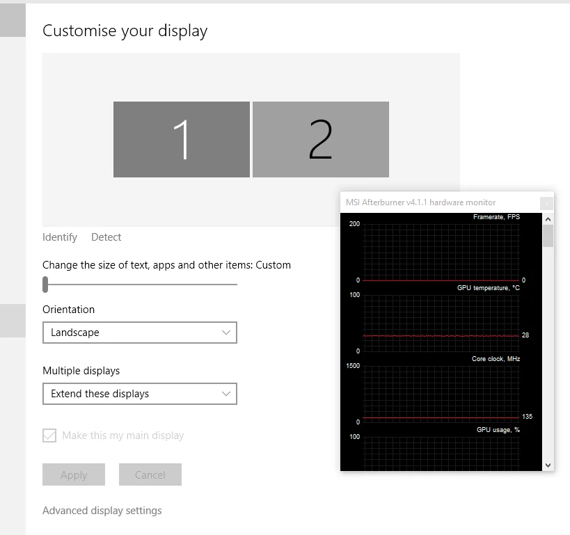

Multiple Displays using DP and HDMI:
Clocks same as single screen, Gpuz showing 135MHz too, something I'm missing?
