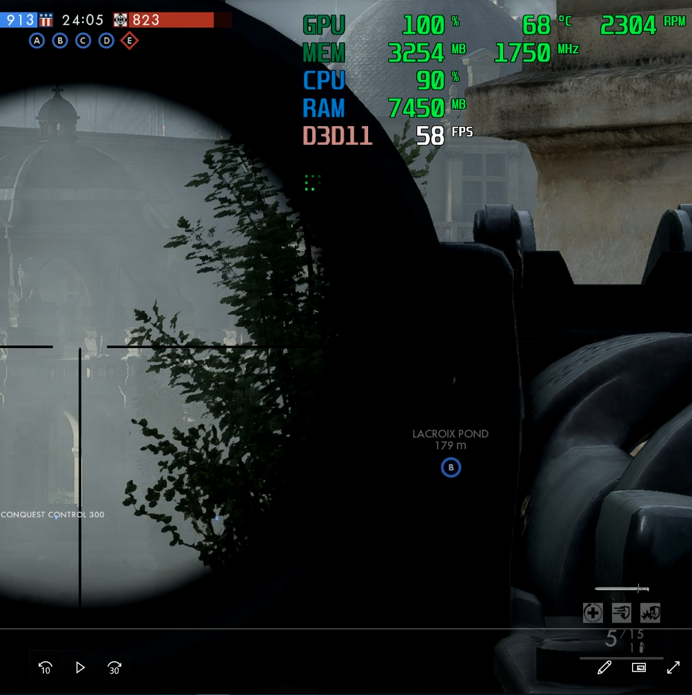

Hi all
Just a quick update on what I have done.
Here is a screenshot before I did anything as can be seen GPU 0% usage and CPU usage at 100% with 23 FPS
I have updated the OS to windows 10
windows 10 downgraded the Radeon software from Adrenalin ver 18. whatever it was to crimson 17.1.1
DirectX 12 has been installed.
And here is an image after the upgrade to Windows 10
As you can see the GPU is now being used but does vary the usage, here GPU usage is 100% and the CPU usage has dropped to 90% usage and now with a 58 FPS
Yes, the CPU still is bottlenecked but at least the GPU is being used and the FPS has increased thereby making Battlefield 1 playable for now.
Will still need a few more tweaks to sort out
Might find running DX11 is better, depends on the core. Found first Gen i cores DX12 helps a lot but not so much with modern ones .
Slap in ryzen 2600 bundle Dela and should see higher FPS, specially if you go on multiplayer
