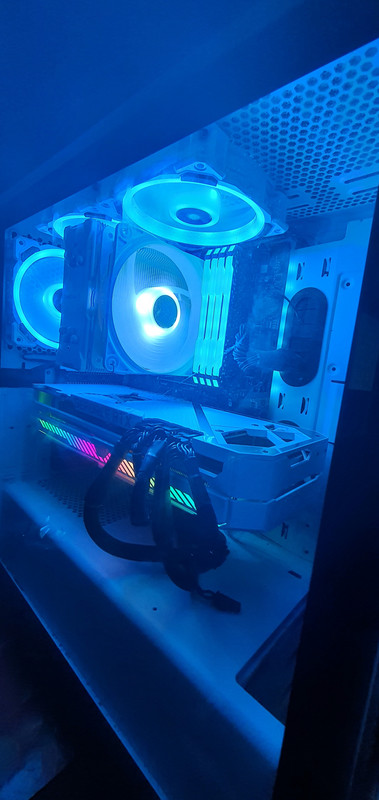

Here is a pic of the setup. I have 2 intake fans at the front, two exhaust fans on top and one exhaust at the back.
I think it might be an issue with my fans, they don't seem to be changing speed at all - looking into that now.

To me it looks like those fans are all only helping the CPU, and the fans at right angles in such a small space will be just making turbulence. The top 2 fans are blowing outwards correct, so the front one of them is literally stealing air from your CPU cooler? I think it would help moving those (or at least that one) forward and having it as an intake fan, with the CPU cooler fans and the rear case fan in series blowing hot air straight out.
What is in the front of your case? The PSU is under the GPU is it? You basically have no cool air coming in for your GPU and the air for your CPU is turbulent and stealing flow from your cooler. Look at my case for example in my sig (link on the Sunlit Mountain words). I have intake fans in the front of the case at the side (but maybe your case would have them tucked behind the front panel) and intake fans under the GPU. All my fans for the GPU are blowing in the same direction as the GPU fans and the side intake fans supply fresh air which circles over the RAM and out through the CPU cooler. I have an AIO and my case has the room for GPU intake fans underneath but you can still improve the flow through your case by better fan positioning.

I do have two fans at the front, you can see them here on a new picture. They are large Artic fans and have no RGB.
With the fans running full, it seems far better. My BIOS has the fans set at DC, so still need to understand this more.
Ok having checked the case link on OCUK, you can fit 2x 140mm fans in the front or 3x 120mm fans. You need to do this as intake fans. The lowest of these will help your GPU the most as its air comes from underneath.
[Edit: just read your new post. So you have 2x 140mm fans already. Ok. See my point below re: speed control via FanControl. Currently through BIOS they are probably set to only speed up when the CPU gets hot, and therefore leave the poor GPU to burn]
I would personally get rid of the 2 top fans as they are so close to your CPU cooler and just allow heat to passively escape upwards (you could use these 2 in the front for now). Keep the 2x CPU fans and the rear exhaust fan as they are, all blowing in th same direction, they are working well.
Lastly, plug in all your fans with PWM sockets (use 2 or 3 way Y-splitter cables if needed) install FanControl, a free bit of software and use it to identify your fans then set all the front fans to 50-75% speed via PWM, controlled by a mix curve of CPU and GPU temp (Jayz 2 Cents has a nice video explaining how to set this up). They should never go below 50% to keep ambient temps down but will ramp up to 75% when either CPU or GPU goes over 70c for example. The CPU fans and rear fan can likewise be set to a CPU curve based on CPU temp so they ramp up speeds together when the CPU hits 70c. You COULD set your GPU curve here too to be more agressive, but I leave mine to the drivers personally.
