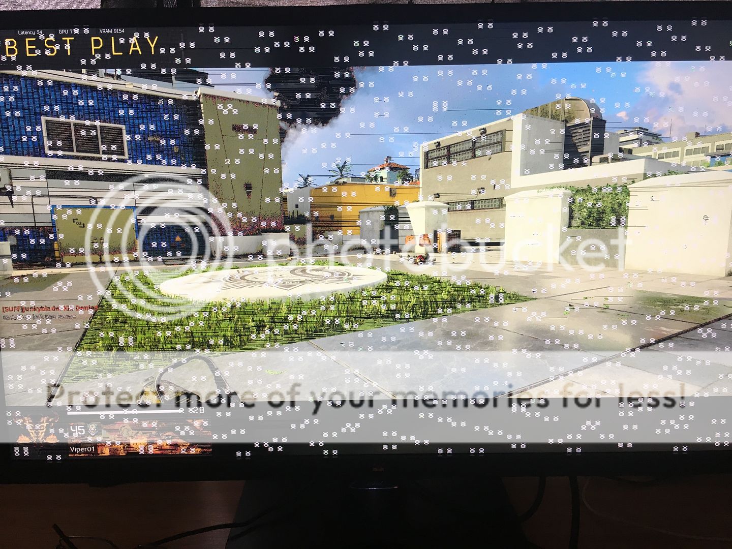

Hi,
Had this PC off OC for about 6 months now, 9700k, z390 arous, and a INNO3D 2080ti and all running fine until last night when I started getting graphic issues when in game and sometimes in windows. Tried new and old drivers but still the same problem. It seems when the card gets warm the whole PC locks up and only way is to reboot it. I've also tried formatting and windows 10 reinstall but still the same problem. I've put a ticket in OC's, i'm sure it's
a GPU issue ..any advise is welcome, thanks Nick https://oi1187.photobucket.com/albums/z383/nicobass1/13th March/IMG_1006_zpsa3ejb3sl.jpg
GPU is broken unfortunately. Quite a few reports of this happening with the 2080Ti and I think it's discussed in the owners thread a lot.
Ocuk should take it straight back but don't know with inno3D how quick getting a replacement will be.
Yep, unfortunately you have 'Space Invaders' playing across your GPU's memory - as @Finners mentioned it's a known fault with the 20 series. More so with the 2080Ti as the cards are pushed harder.
