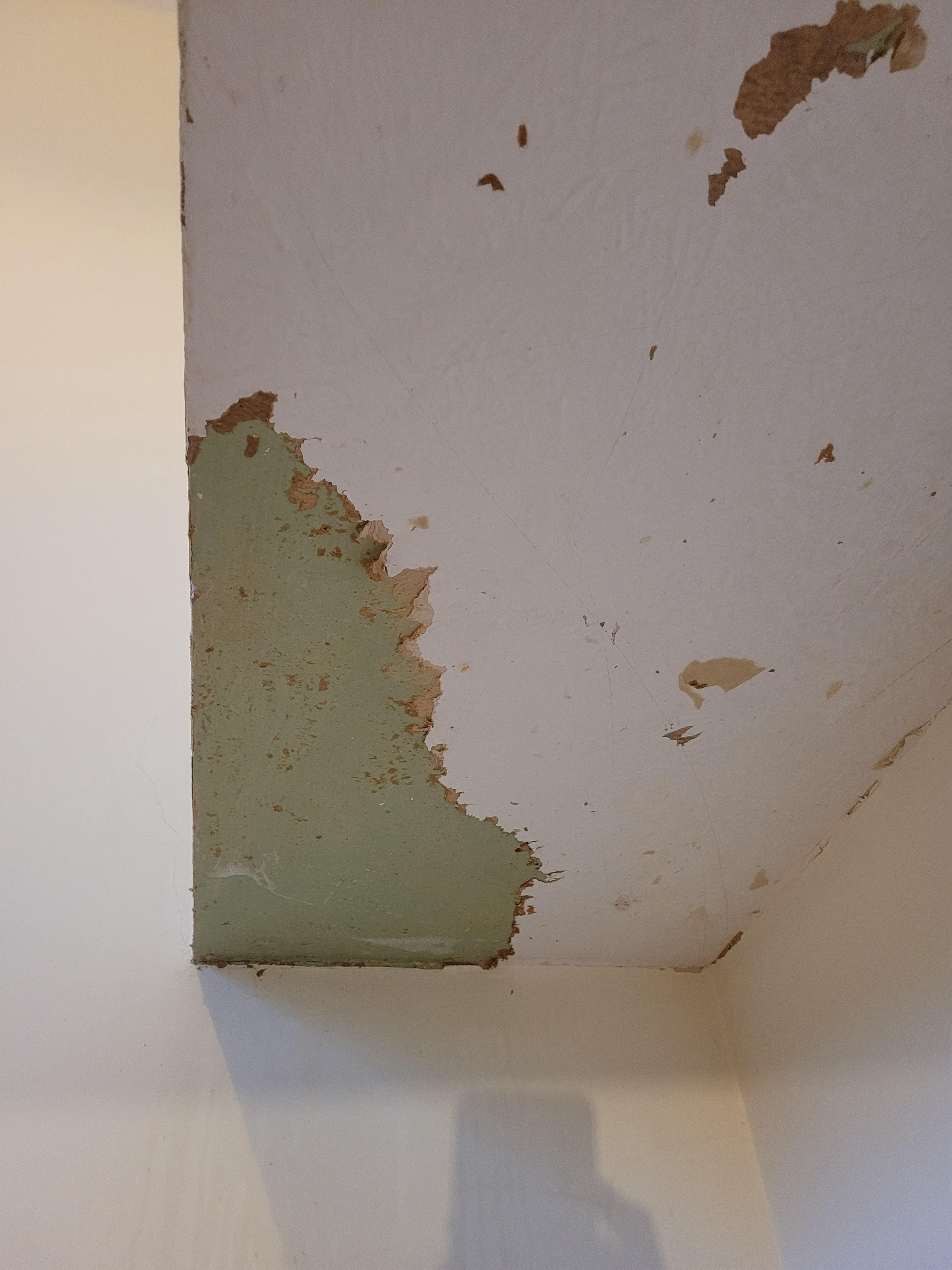

Hi all, does anyone know what this green board in my ceiling is? It's got 2(!)layers of anaglypta textured wallpaper on it. It's a 1940s build house and the wallpaper and ceiling will be at least 20+ years old.
Can it be skim coat plastered straight onto it? Would it need reboarded/over boarded?
Fortunately 2 other downstairs rooms which I have removed wallpaper from are just have standard plasterboard rather than this.. I'm open to pulling the ceiling off downstairs but hopefully I don't have the same upstairs!
As far as I'm aware this is less likely to be moisture resistant plasterboard?
Picture - this is a part underneath a closet by the stairs but the same applies for all the downstairs hallway ceiling i believe.

Board on top then skin if in doubt.
Rather than overboard id probably just pull/take the board off(saves me a couple mm and the finishing will look better.)
Yep just normal board don’t worry about it

What is your basis though? A blanket post of 'asbestos' is useless.

Do you still have any basis for it being asbestos? I.e. Was it common in plasterboard are you making pure guesswork?
If it were the original 1940s ceiling I'd be expecting to see lathe and plaster ceilings which I have not as of yet.
I googled Green plasterboard and found out.
Gypsum plasterboard with moisture resistant additives in the core and special green lining paper for easy recognition. ... Recommended for use in intermittent moisture applications where additional performance is required such as in kitchen and bathroom walls and ceiling installations.
Maybe they used it in the hallway as that is what they had on hand.
Asbestos was used in wall and ceiling boards.
Maybe there used to be a boiler cylinder on the other side so they decided to use moisture resistant?
That is true! the cylinder is above this section of green plasterboard and adjacent it.
That would be a fairly forward thinking reason to use moisture resistant board. Is that fairly standard practice?
Most things in my house have been bodged :cry: so never anticipate anything thought through.
Asbestos isn’t green.

This is crap and very dangerous advice. Don't listen to this.
ACMs can come in any colour.
ACM’s can yes…….
asbestos however isn’t green. It’s factually correct. Calm down love.
Better safe than sorry of course - as a surveyor I find asbestos in many places and 99% of the time it’s best left well alone.
in this case, it would be unusual to say the least for that to be asbestos. The green appears to be the type of board or lining - not an ACM.
but who knows - nobody does for sure without a test so if you are ever unsure, get one done. Let’s not get our knickers in a twist about it.
