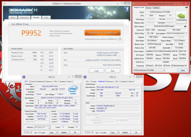

Starting off with Firestrike, we notice that the GTX 970M in the GS60 will go as far as the drivers will allow us: 135MHz above stock levels: a GPU frequency of 1059MHz and boost at 1173MHz. Obviously, the 970M is down on shaders compared to the 980M as well, but it also won’t overclock as high. The 980M in the GT72 reaches 1173MHz GPU with a boost frequency of 1262MHz, while its memory also overclocks better, to over 6GHz. The GS60 and 970M falls some 80MHz short of the 6GHz mark.
At stock frequencies, we hit over 9200 points in 3DMark 11, with the GS60 and 970M, whereas the GT72 with its 980M clears 11000. With overclocking, the 970M comes close to the 10k mark, which no doubt would have fallen with higher frequencies if it hadn’t been for the driver limitations.
Moving on to Fire Strike, we see a similar picture. The 980M is comfortably clear of the 970M, but the 970M still offers impressive performance for a mobile chip. Over 6500 points in Fire Strike, and an additional comfortably achieved 800 points with overclocking.
