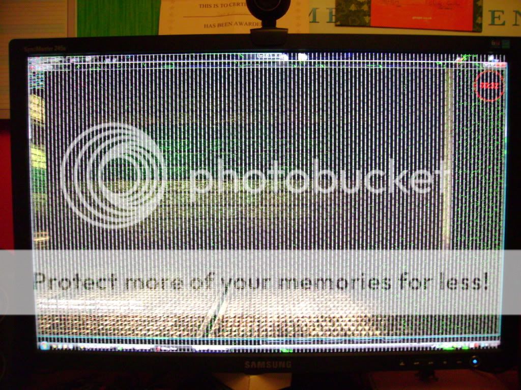

Also, I took a picture and a short video of it dying...
hehe yeah mine looks exactly like that video, id like a 5870, was thinking about getting another 1 for crossfire as it would be kind of like buy 1 get 1 free lol, i think in the long run i'd regret getting a 295 when i cant run things in dx11.
