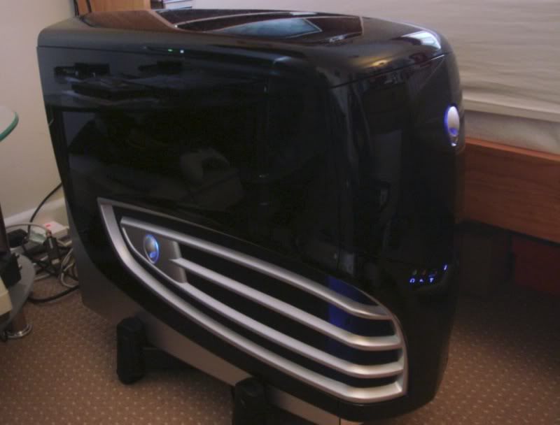

Not only that but the Predator 2 pictured above had a pretty crappy airflow. It did have a side fan (120mm) and a front intake (120mm) but the front intake fan was far too far away from the GPU to really feed it any air. Couple that with the fact that most of them were liquid cooled and you have heat issues.

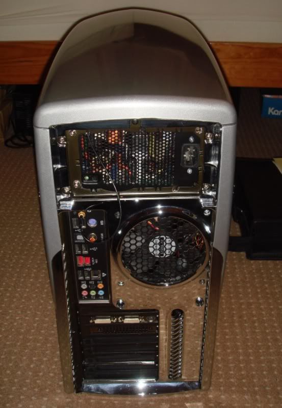

If you look at the back of the machine and it is a predator 2 you will notice this cover.
This was a huge problem for hot rigs. Basically the trick was to mod it to look like this.
As otherwise the hot air would not get out and would end up back in the case.

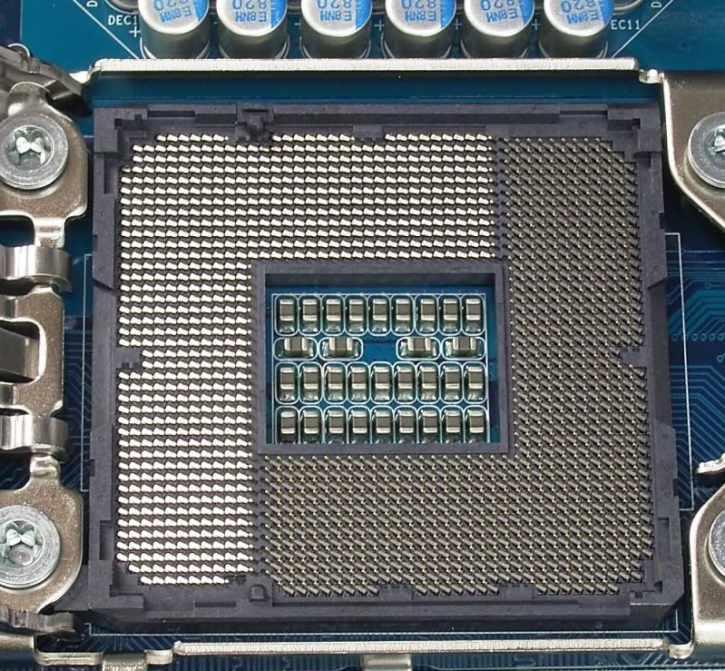

Ah yes, here we go :)
One healthy socket.

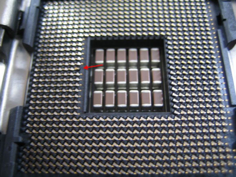

One with a bent pin.
Now I would say that if you have up to four or five bent pins you may get out of it. They are like leaf springs, with a tiny pin atop the end.
They can be worked with a wooden tooth pick. Just gently pried across. In my case one had actually folded backward over itself but I still managed to save it.
If, however, they are blue or burnt looking then they are shagged and it'll be a new mobo.
