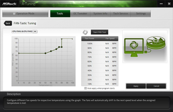

Sorry I missed this post before, really good info here too thanks :) The motherboard I have for this build is the ASrock extreme6. I know how to alter the speed in the bios and they have a piece of software called A-Tuning which has something in it called FAN-Tastic Tuning which seems okay. Changing in the bios is probably the way to go though right?
I would set the fans manually .. either in Bios or if in software. Asus and Gigabyte software works fine but don't know how the ASrock works. As far as I know nobody has had any luck using the Asus fan auto-tuning software. My guess is the Phanteks PWM controlled fan hub and auto-tuning software are not compatible .. probably because of the delay caused by the hub.

I was yep, I had it plugged in to header 1. I could only bring the noise of it down when I took it down to about 10% speed in the software.
FYI the software looks like this.
After I had tried that fan test button I was getting the same RPM at 30% that I was at 100%. Can't show my real results as im at work.
On my gigabyte I set the minimum at 30%@30c and maximum at 100%@65c. As CPU never gets above 50 the 1300rpm fans never run above 1000-1100rpm. :D This is in Primo now and was similar in Define R2 modded with 140mm fans.
