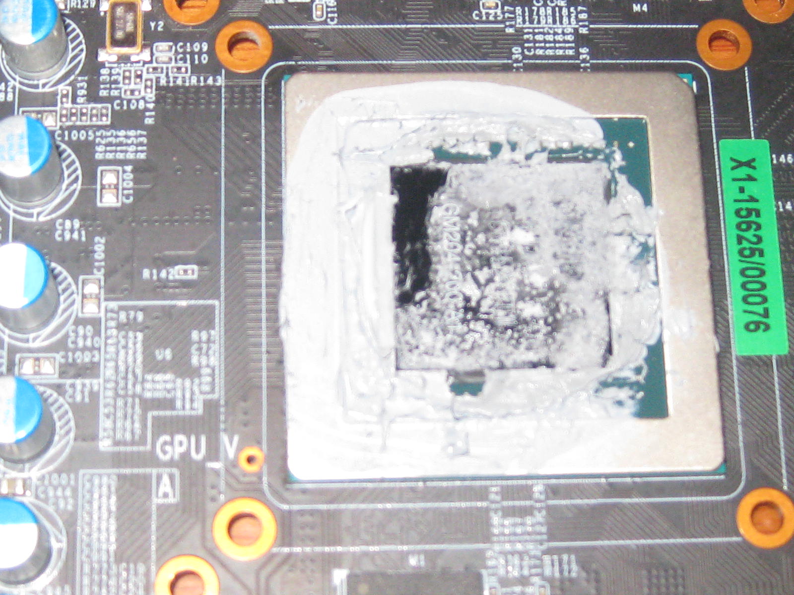

I got a new GPU in summer last year. As temperatures decreased during autumn and winter, the GPU temp increased, which didn't make much sense. Eventually they started scraping 80C on load (an increase of 15C since I got it) and I knew that unless I did something about it, it would be reaching 90C or more this summer. So I removed the heatsink to have a look at the paste. This is what I found:
lol...
Cleaned that mess up, added new paste properly, and temps are now 15C lower again.
Moral of the story is don't forget to check the spread of the paste if you experience heat issues. Even if there was no heat problem to begin with, badly applied paste (or too much paste) can begin expanding outwards and causing issues soon enough. And sometimes, they get it very wrong (the amount if not positioning) at the manufacturer's.
