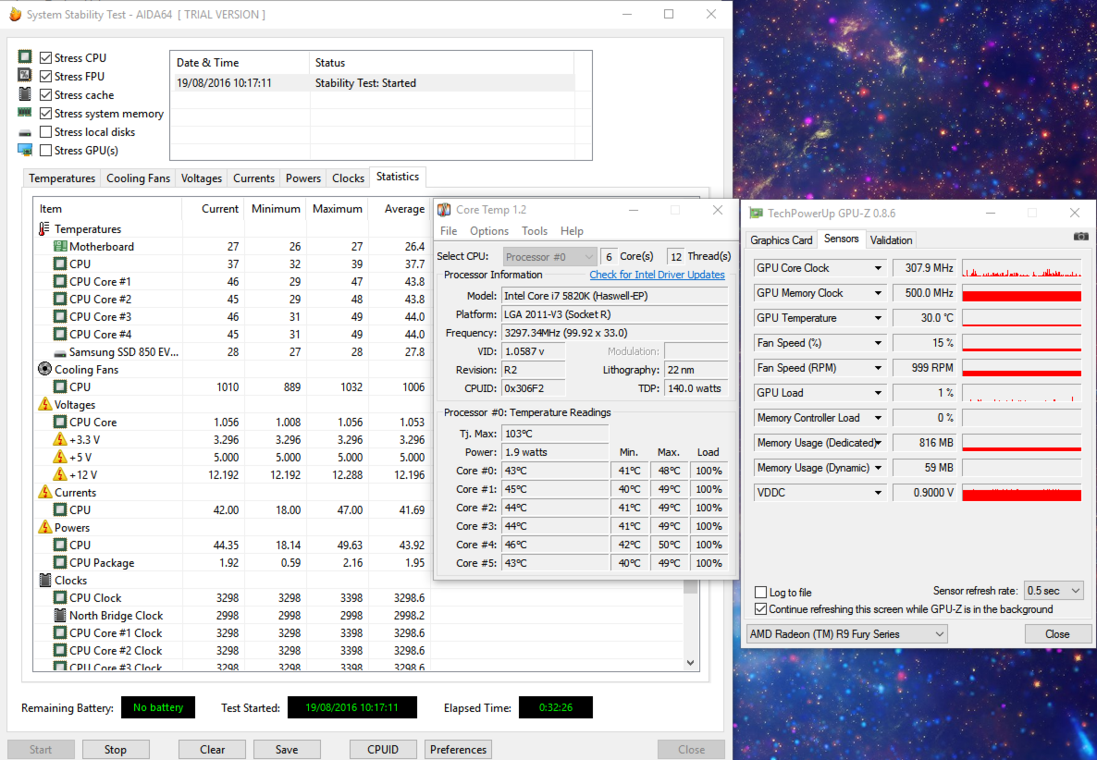

Here's what my system under Aida64 runs at stock vs overclocked.
Without Overclock
With Overclock
Did you manually set your voltage for the CPU overclock?
I know for my 5820K if the voltage is set to Auto it applies a very high 1.25V; when 1.08 is more than sufficient for a day long AIDA64 stress test.
It's worth noting though, that even with just that 0.08 increase from 1.0V my CPU temps went up 10 degrees at Max peaks.
Might be worth checking the voltage to see if you can knock it down a bit.
Also remember that the 4770K did not have soldered TIM under it's IHS. This results in higher temps as well.
Without Overclock
With Overclock
