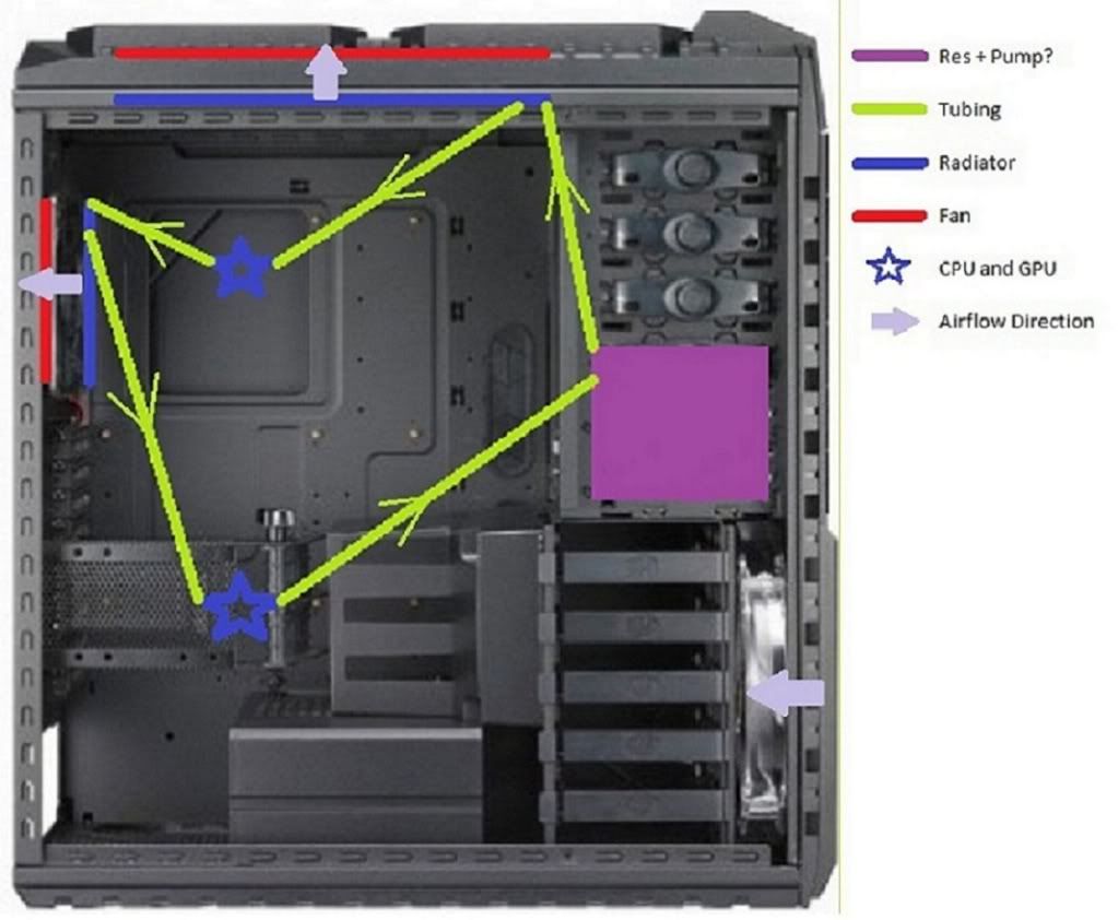

The Plan
Parts:
Res+Pump;
This is where I'm struggling with what to choose and where to put them. I was thinking a bay res because I really like the idea of having it showing at the front of my pc. But then I'm not sure where to go with the pump.
Tubing;
Masterkleer PVC (1/2' ID) UV Clear/Blue
Radiators;
XSPC RX360 120mm
http://www.overclockers.co.uk/showproduct.php?prodid=WC-048-XS&groupid=962&catid=1523&subcat=1526
XSPC EX140, I may go for something thicker here. Also considering putting the 360mm rad above the fans inside.
http://www.overclockers.co.uk/showproduct.php?prodid=WC-087-XS&groupid=962&catid=1523&subcat=1524
Fans;
120mm Scythe Gentle Typhoon 1850RPM. Standard rad fans from what I've read. If anyone knows of any decent blue LED rad fans I'd take a look.
CPU Block;
XSPC RayStorm CPU Copper or EK Supreme HF Copper Plexi.
http://www.overclockers.co.uk/showproduct.php?prodid=WC-092-XS&groupid=962&catid=1519&subcat= or http://www.overclockers.co.uk/showproduct.php?prodid=WC-012-EK&groupid=962&catid=1519&subcat=
XSPC is higher end from what I can tell, but I like the idea of seeing the liquid in the plexi block.
GPU;
EVGA GTX680 Hydro Copper.
http://www.**********/products/2gb-...5-gpu-1150mhz-boost-1215mhz-cores-1536-2x-dl-

Edit, I have the res where you have it on your pic, but I have the pump in the bottom of the case next to the PSU.
