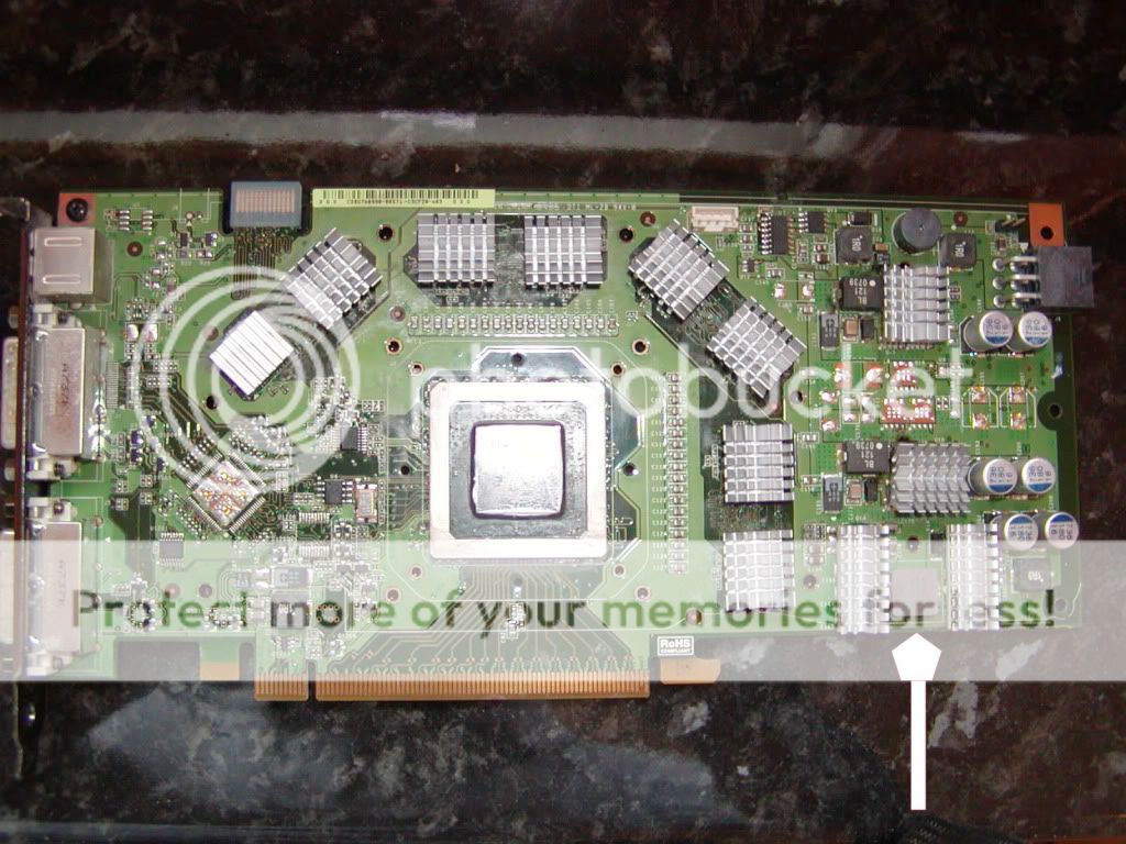

I've had another look at it, as well as a sniff. The burning smell is coming from the area arrowed in the photo. Does anyone know what that component is? I'm guessing something to do with the power.
Hmm, my 8800GTX emitted a plume of black smoke out it's exhaust last week which stank, it's not a good smell :p Could it be the VRM area? Since Furmark is known to place a huge load on cards, hence some 4870/4890s can't take the extreme amperage and lock up?
Seems to be part of the VRM, furmark hammers this more than anything really, perhaps the t-rad and sinks don't cover this area as well as the stock cooler, you wouldn't be the first to have that problem.
The card was probably on its way out anyway. What you pointed to is a power phase I think. Don't quote me on that though.

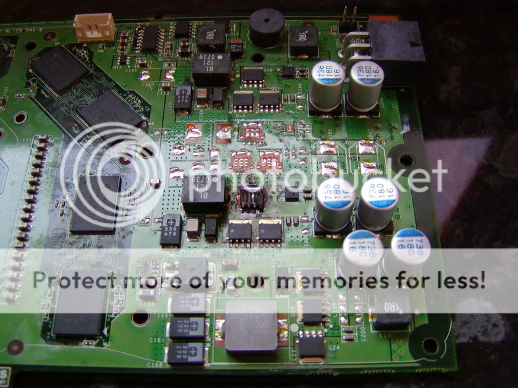

I stripped of the heatsinks to have a closer look, and found the charred remains of a chip.
Looks like it took a right roasting, it had a heatsink on it as well as per instructions.
