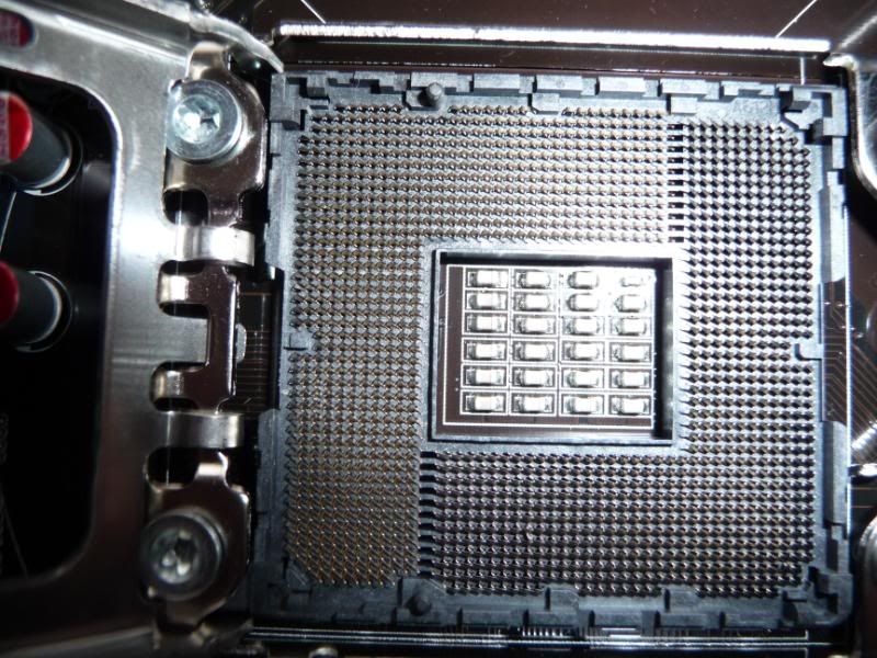

Difficult to see, but they look fine now. You will probably never remove your CPU so I dont think its anything to worry about.
well if you try and rma it they'll say you bent them (not saying you did but thats why they ship them with protective covers on them, gives them total impunity basically) so I'd see if it works first before considering any sort of plan B.
I installed the CPU after resettingthe pins, all booted Ok and uasing it to post now.
I have installation insurance, so not sure wethere to return it or leave us.
if you were going to have a problem with your CPU pins on the mobo then it just wouldn't post.
Its one of those faults where it either works or it doesn't so I guess seeing as it works, keep it!
