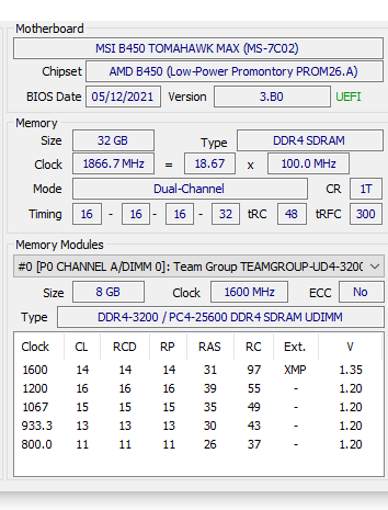

Hello,
I'm trying to upgrade my 4 year old PC without going crazy with the hope of being able to play City Skylines 2, probably on lowish settings, and just give it a general boost until I go AM5.
I've got a B450 TOMAHAWK MAX motherboard and have just upgraded the CPU to a Ryzen 7 5800X.
I'm now wanting to swap my memory for something hopefully a little quicker and from 16gb to 32gb which seems to be the minimum now a days.
I'm currently running some Patriot Viper DDR4 25600 CL16 MEMORY (8GB X 2)
PV416G320C6K​
I'm not quite sure what my best route is now...
Add 2 more identical sticks of ram to give me 32gb
Swap to 2 x 16gb ram of something different / slightly quicker
I don't need anything with fancy lights etc just something thats stable / quick and possibly works with the XMP boost on my mobo. Max I want to spend is £100...I was looking at this https://www.overclockers.co.uk/cors...-25600c18-3600mhz-dual-channel-my-4d1-cs.html but not sure if theres anything better before going ahead.
Many thanks for any help
