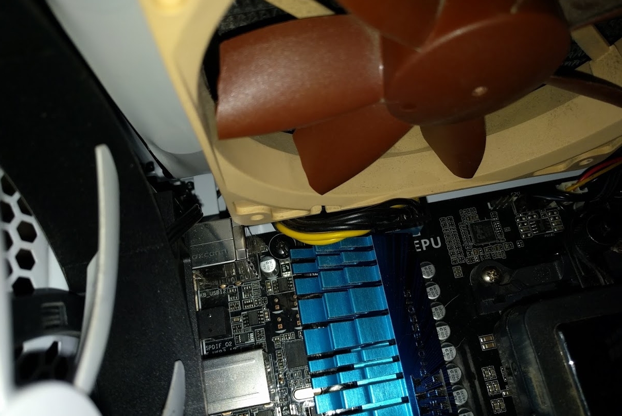

Had a quick check to make sure top rad fits, it's safe to say it'as very tight on the 8pin power plug! :eek:

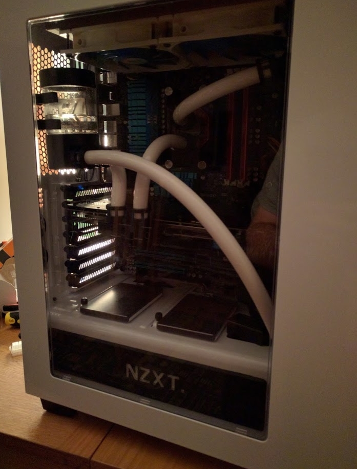

Well loop completed last night
I intended for the long return tube to come out the bottom of the res but that leaked so had to amend it. When I drain it out to put the pastel white in I think I'll add a 90° compression fitting so that it goes downwards and not across. Need to add a proper drain port too.

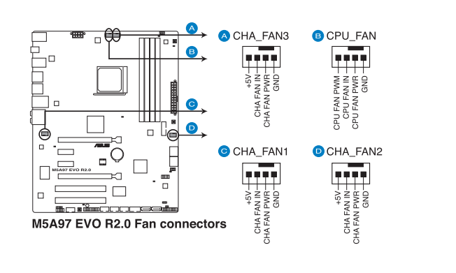

Ahh that's interesting. Just checked mobo manual and it says this
So only CPU fan header is PWM.
Thanks for pointing that out.
Agreed on fan opinions, so many different opinions and no way to quantify someone's experiences.
I'm thinking it may be best to use non pwm fans and save the CPU Fan header for if/when I get a PMW pump
