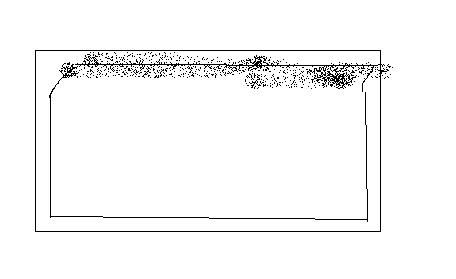

EDIT: I'd be intrested to see this distortion of you could get a picture.
I can try and describe it to you, distortion is probably not the right word, its more of a warping at the very top of the screen, sort of twists the picture at the top, while the lower 95% of the picture is as it should be. Its as if all it needs is to adjust the skew settings you used to be able to get on old monitors or press an autoadjust button, but you cant.
I understand what you mean, seems like a poor job on the TV's part. You won't have that issue with HDMI I'm sure of that.
