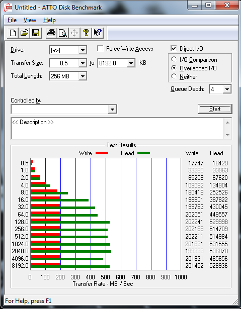

download and run atto and let us know what your your read and write speeds are maxing out at or if you can provide a screen print of atto once its run

Here's an ATTO benchmark I just did
I still notice pauses from the SSD like with normal hard drives?

Ah, I had similar speeds with my M4 untill I enabled AHCI mode.
There was a guide somewhere on the storage devices section on how to enable it once windows is installed, now my M4 returns 450MB/s read speeds.
edit: this is what mine actually now returns
with the marvell controllers on that mb,those would be the best speeds on sata3 for the op,they improved them with the later boards

makesure the ssd is 4k aligned,check in as ssd benchmark,you might do better putting it on intel sata2 ports as the marvell ones are poor
