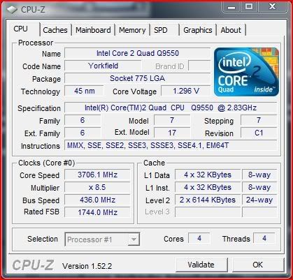

what stepping is the cpu?
Does that tell u the stepping?
wil check those links when i get more time, at present it looks a bit daunting :D
