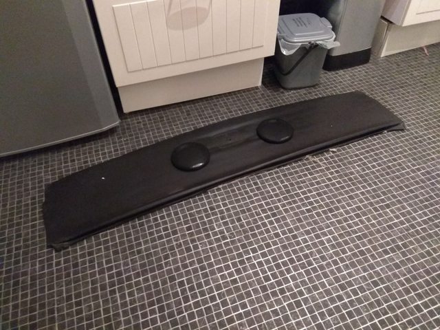

So! I'm putting in speakers on my rear parcel shelf. I've gone for 10cm speakers because of this:
Original hole for centre speaker is 6" I think, but there are conveniently enough four 10cm holes. I can just drill holes for screws and not have to monkey around too much with the structural parcel shelf. If I was making the holes myself, I'd go right between the two sets. But I'm not doing that. So do I put them here:
Or here:
I'm torn. I kind of feel like the outside set is better but maybe it looks a bit awkward. They'll be much more out of the way in the boot as well if I put them there, but I will have to trim a bit of the 'wall' of the boot so it doesn't touch it.
I've got new vinyl to retrim the parcel shelf and I will probably stick down some sound deadening while I'm about it. May get some MDF as well and replace the board although it's pretty sound to be fair.
What do we think?

another vote for outside ;) (lol, was going to say to split the difference and slap in the middle, but then read about the existing holes meaning you only have the 2 positions you can choose from).
Outside looks more normal
Old mate who used to be a car hifi installer always said rear should be mono, you want the stereo imaging from the front not getting mixed up with the rear.
He always used to prefer stereo front and actually only bass from the rear but wasn't my cuppa, but you could tell it was more correct in the sound.
(lousy for rear passengers though)
Close together will make it sound mono.
If you listen to music made after the 70s, further apart is better.
Stereo imaging won't really come into play with all the sound coming from behind anyway.
I have to agree with him. I've custom fitted 9 speakers in my car and 8 of them are forward of the listening position. Only the sub hangs out in back because there simply isn't room up front :D
"HiFi" in a car isn't for everyone (nor is it easy) but it floats my boat.
There's two speakers up front as well but they're also 10cm and they're in enclosures under the seats! I'm definitely not shooting for hifi, it's a matter of getting some music into the car and keeping it fairly low profile.
I've gone for the outside, got the new vinyl on there now. Just need to work out how to drill these holes now! Terrible access. Might have to look into a 90 degree drill attachment or something.
