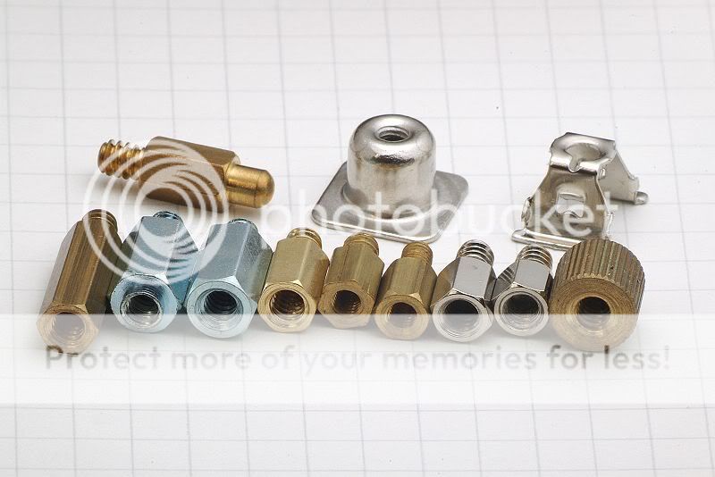

Here's a photo of the different sizes. As far as I know, the standard size is 32mm on the thread. (maybe if you could measure the thread on yours and compare)
Standoffs do come in different sizes and like you said, you're clearly competent enough to not make any obvious errors. The ones provided obviously are the wrong size for the case. Might be worth contacting Lian-Li about the issue. In the mean time you can buy them online dirt cheap.
Do you mean 3.2mm?
