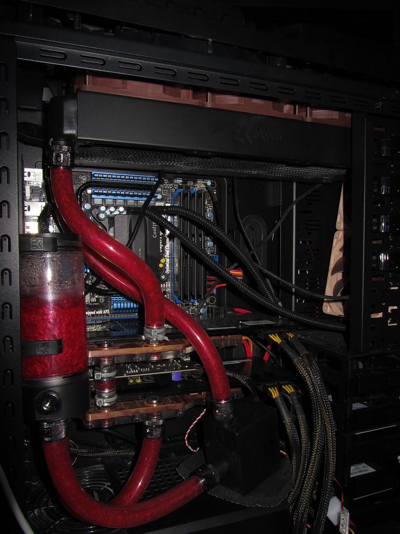

Why not keep the HW100i on your CPU and mount the rad in the front of the case, and have a second GPU loop? This is how I ran my first loop:
As for pumps, it depends on your budget. If you're looking to get into water cooling for a long time over a few builds and have the cash get a D5, if not an EK 4.0 will run a low restriction dual gpu + cpu loop + 1 rad.

That's an EK 250ml res.

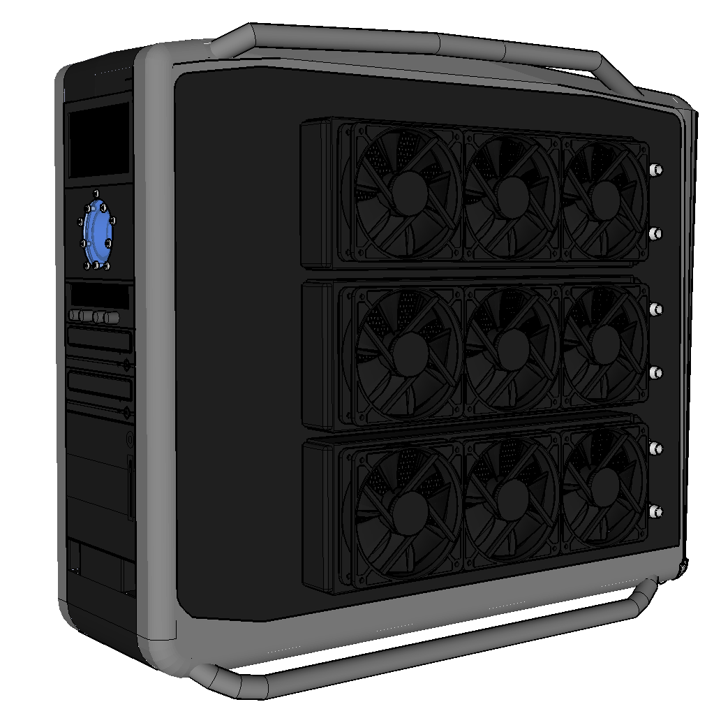

This is how I am mounting my external radiators, any damage to these and I will just get a wet desk:
