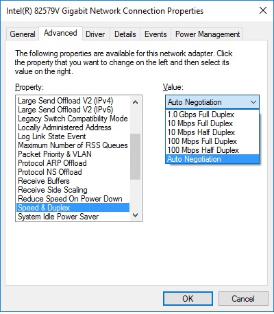

I have noticed this though when looking at the rather net controller on the PC
How can I change this to allow the full gigabit connection?

And looking at the Speed & Duplex
the values I have are
10Mbps Full Duplex
10Mbps Half Duplex
100Mbps Full Duplex
100Mbps Half Duplex
Auto Negotiation (this is the one its currently set at)
So despite it being a 'gigabit' Ethernet controller that option isn't there ?? :confused:
Shall I bang my head into a wall a bit more?
Your homeplug adapters only have a 100Mbit interface
So you believe it IS the homeplug that's the issue and not the fact I cant seem to set my Adapter to 1Gbps like r7Slayer?
If that is the case its the homeplugs can better plugs be recommended? as I say I cant plug PC into router directly as its on another floor of the house.
