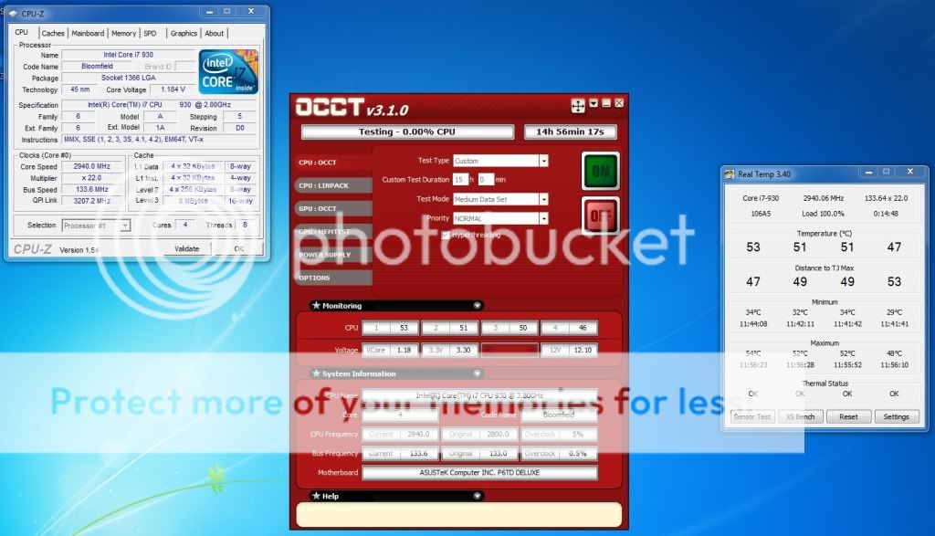

Temp in stock -
Thanks
I was surprised is well, but never have any experience with water cooling – what can be wrong ?
Your temps look fine, i7's just have a higher temp readout than other chips I think they have more accurate sensors.
Don't use OCCT to stress test though get LinX or IBT.
Right – temperatures are not too bad :D then – what wrong with OCCT Perestroika and how about some help with overclocking ?
This is true, and I don't mean to be rude- however those are still very high temperatures. Mine, and many others from what I see idle at high 30s to low 40s... and that's on air cooling.
Surely something needs looking at - What case is it in? (hows the airflow etc?) I'm not familiar with water cooling but I know it's supposed to be better than air
According to his Coretemp screenshot his CPU is idling in the low 30's.

For the temperatures – according what I was reading – they are not too bad, but they have to be lower… I planning do cleaning of system, change out liquid and etc… probably that will improve temperatures. For the RAD, well I got what I got, probably that was not the best, but for the single loop - will do ( I think). I using MX-2 thermal paste, but is over 1year old, but probably still be do the job is well.

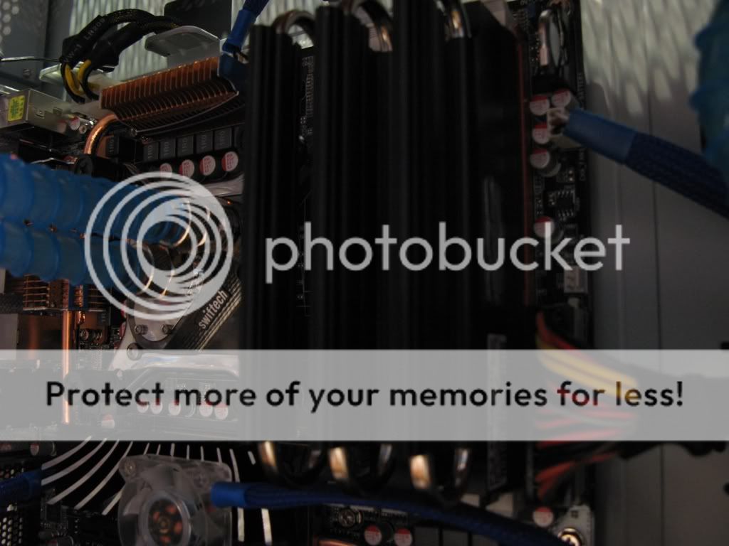

In general – I happy with current setup. Some pictures – if you don’t mind…
