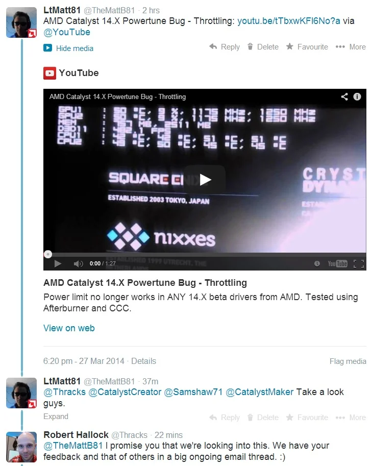

I can confirm that on 14.4 beta the physics score is fixed.
Now its the only thing needs a fix, is the fan control.
