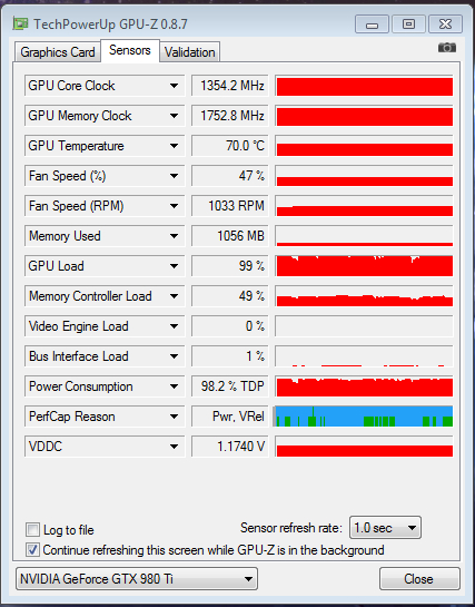

Hi guys, I am wanting to overclock my Palit 980TI today but first I thought I would run a heaven @ stock just to get an idea of temps etc, just wanted to check does everything look ok as under the 'PerfCap Reason' section it's coming up with 'Pwr & Vrel' is that normal?, just wanted to check before I start overclocking the card.
Also any tips overclocking my card, what programs to use etc :)
A quick look on google and I found:
vRel = Reliability. Indicating perf is limited by reliability voltage.
VOp = Operating. Indicating perf is limited by max operating voltage.
Pwr = Power. Indicating perf is limited by total power limit.
Thrm = Thermal. Indicating perf is limited by temperature limit.
Util = Utilization. Indicating perf is limited by GPU utilization.
Don't believe it's a problem, just a case of the card attempted to increase clocks, but couldn't as it hit the Power limit.
Whether the Power Limit or vRel can be increased, I don't know - hopefully someone more knowledgeble than me with regards to NVIDIA Cards will be able to elaborate.
