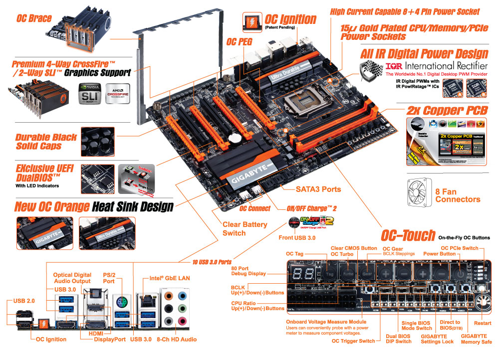

The board also has a dual bios, so make sure you are on the one that you have updated.
I have managed to get into the bios but I have not flashed from F6 to F7 I moved from F4 to F6 originally and it didnt work.

Btw what is the rest of your build like also which psu?
Click on my build log in my sig it will give you everything in detail -

To make matters worse booting into bios is hard enough with how fast this computer loads into windows by the time the signal hits the screen im already in windows and spamming del or f2 doesnt work due to keyboard not actually being detected untill in windows ( this is due to how fast it boots ).
I used the boot to bios button on the mobo this worked ONCE.... now every time i press it nothing happens.

Here you go.
